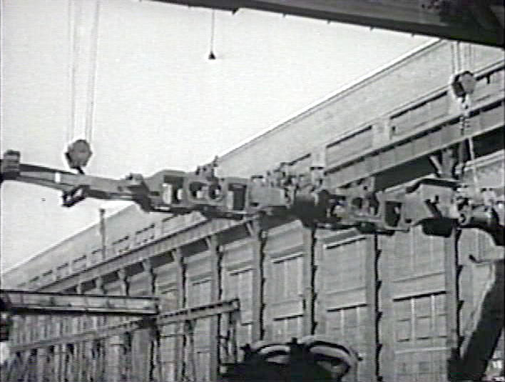

Have they indicated how they will build the main frame? Seems to be at the heart of this project. Everything else can be made; it's just a matter of money and actually doing it. The huge, complex one-piece original frame with cylinders, etc. would be a problem nowadays.
As has been said by me and others, it would likely make sense to divide it into segments and use modern welding techniques to assemble it and avoiding losing a lot of time and money on failed attempts to do it in one pour. But it would take some engineering to determine the best places to divide it and design the mating surfaces in the best way for later joining.
