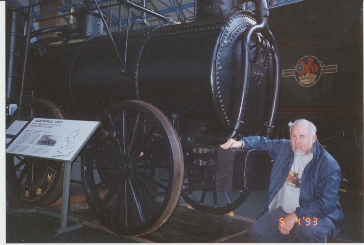

Out here on the West Coast, we would place the development of fuel oil firing as major advance. It made use of local resources (at least in California), it eliminated the difficulties of dealing with solid fuel, either with the fireman's scoop or the mechanical stoker, and it made possible the Cab-forward design for the Southern Pacific.
Regarding Mr. Trevethick--his locomotive might be called a "proof of concept", but after his experiments, the idea lay dormant for over a decade, presumably while other aspects of technology caught up. One might consider that Edison didn't "invent" the electric light, but he made the first one that worked and made economic sense. Likewise, Stephenson is creditied with building the first steam locomotive that could really do the job.
File comment: Here's an 1829 locomotive at the National Railway Museum in York, with the exhaust steam pipes routed to the smokestack (or is it the chimney over there?)
