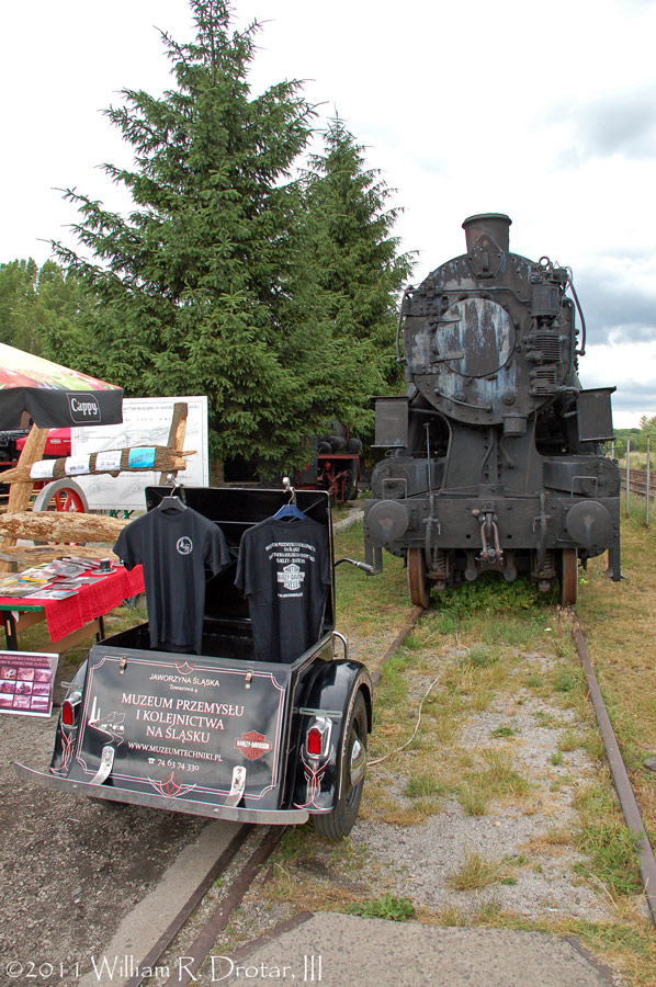

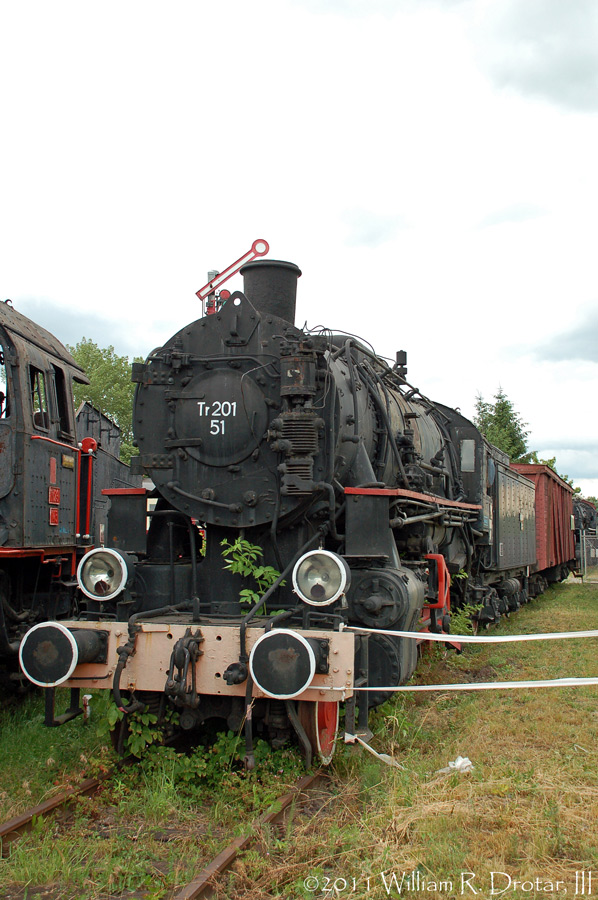

There are also 3 S160's left in Poland, they are:
1. USATC 5164, now Tr201-51. Original boiler was Lima 8823, current boiler is ALCO 70301. Located at Jaworzyna Śląska Technical Museum, Jaworzyna Śląska, Poland.
2. USATC 2438, now Tr203-296. Original boiler was ALCO 70787, current boiler is ALCO 71092. Located at Jaworzyna Śląska Technical Museum, Jaworzyna Śląska, Poland.
3. USATC 5804, now Tr203-451. Original boiler was Lima 8739, current boiler is Baldwin 69545. Located at National Railroad Museum in Warsaw, Poland.
I have no idea what the original USATC numbers for the replacement boilers are, Polish locomotives are identified by the serial numbers on the frame, and boiler swaps were very common until the end of steam.
File comment: Tr201-51
File comment: Tr203-296
File comment: Tr203-451
