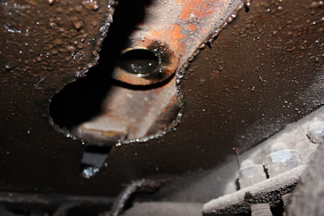

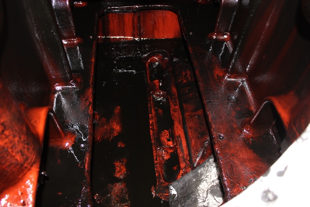

Digging into the bowels of the 539 engine, i find that the oil pickup is centrally located in the block in the No. 4 cylinder crankcase. There is an oil passageway molded into the bottom of the engine base casting that leads forward to the oil pump. The main oil drain is tapped into the bottom of this passageway about 8" from the inlet. There is a small lip at the oil inlet that keeps the sludge from being sucked into this passageway.
So it does appear that withdrawing oil from the main oil drain for the prelube pump would result in clean oil without sludge. I plan to change the plumbing of the oil drain as follows. Instead of a 2" nipple coming out to a 1 1/2" reducer to a 1 1/2" elbow and pipe running to the side of the locomotive, I am just going to come out with a 2" nipple, then tee and a 12" nipple with valve at the bottom. I'll take a 1/2" suction line off of the branch of the tee to the prelube pump. The 12" vertical nipple and valve will serve as a water and dirt collection chamber, to be drained at each maintenance interval.
Prelube oil will pass through a filter on its way to the pump, before being distributed to the engine. The prelube system will be a permanent installation that can be operated by pushing a button in the cab.
I have about half of the crankcase cleaned so far. There is some sludge in there, probably half a bucket's worth. A few slivers of babbitt have been found but so far no large accumulations.

We run a good sized fleet of 539 power. I would not recommend pulling your oil from the oil drain line for an initial prelube. Unless you have drained the oil and cleaned all of the bottom of the block. You would be amazed at how much debris accumulates on the bottom of those blocks. Having a filter on your prelube set up is a must. The port on the side of the block is a line that crosses over from the cam bushings to the turbos. This place is an effective way to get oil to the crankshaft, but it puts anything in the oil directly to the bearing surfaces.
I use a 110V motor on a small gear pump (much like the fuel supply pumps). Ours has a filter built in. I generally use new oil any time I prelube. If I have to get it out of the engine lower block, it is always a suction line that is well off the bottom. Some of our 251's have permanent lines to hook up the pumps. You can also use an off the shelf barrel pump right in your oil supply. I've filled empty locomotives this way with excellent results. Sometimes it will even generate oil pressure on your gauge!
