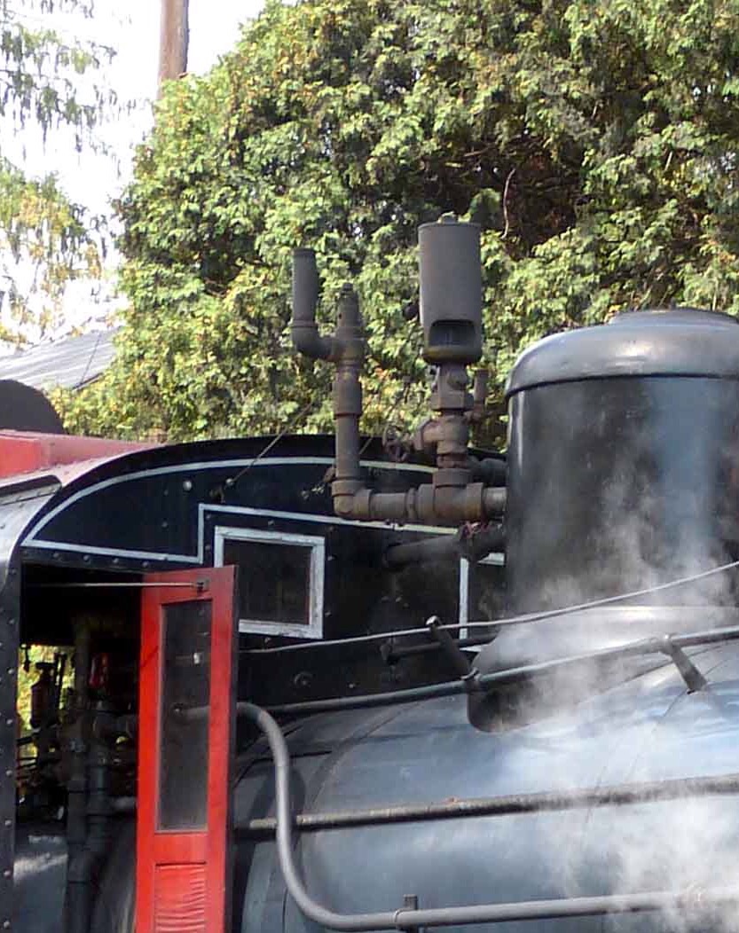

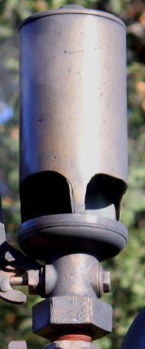

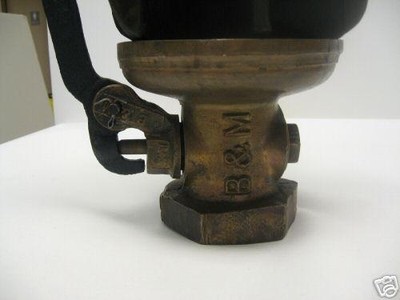

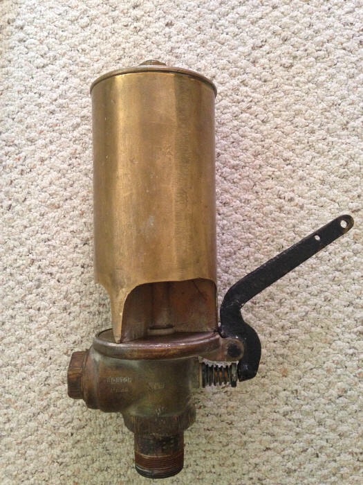

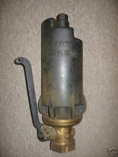

SR6900 wrote:
We had a discussion about the 470's whistle those photos on the now gone Horn and Whistle Board. I suggested that it was a Hancock Short bell 3 chime, but apparently the Lonergans are similar as someone referred that is what the one now on the M-K 3 in WV is.
It's not a Lonergan. Lonergans have rounded openings, with a short flat area at the very top. They're also built differently than the Maine Central whistle. It has a hollow channel through the bell, that fits over a stud threaded at both ends to hold it to the bowl. Lonergan tops are one piece castings (except for the lid, which does nothing structural), with an integral threaded spud that sticks out of the bottom and screws into the bowl.
The bell of the Maine Central whistle looks exactly like a short flat top Hancock to me. Built the same as well. Below are some photos of a Hancock. From a distance, the bowl looks exactly like a Boston & Maine bowl. A friend has a B&M 6 chime; it has "B&M" cast in the side of the valve body in large letters.
I'm curious about the whistle now; maybe Earl Knoob can get us some closeups?

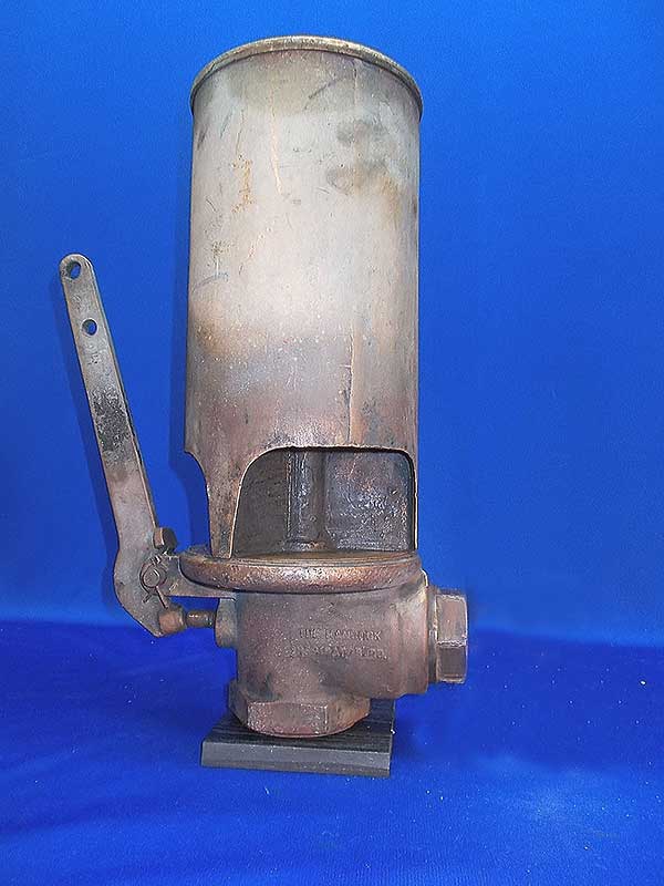

The first thing to determine (if possible) is did Maine Central make their own shop-made whistles, or did they buy from an established maker? The whistle in the photo of 470 looks more like a Hancock short bell three chime than a Crosby or Lonergan. Crosby whistles did have rounded mouth openings like that shown in a previous post. Lonergans had a more squared off mouth opening like this 6" 3 chime specimen.

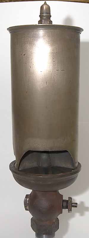

The whistle in the photo of 470 looks more like a Hancock 3 chime short bell whistle than a Crosby or Lonergan. Like this one:

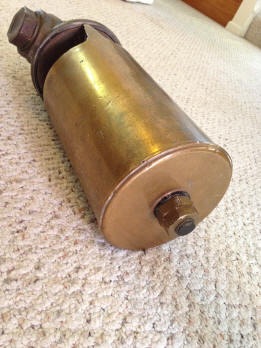

Hancock looking top, but with a bowl like this:

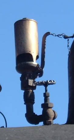

There is another thought that I think has been brought up before. What stopped shops from putting off the shelf bells on in-house bowls? The Conway Scenic 7470's 3 chime is, as far as I can tell, a kitbash of a B&M bowl (B&M) with a Hancock bell. Could it be possible that Maine Central operated in a similar fashion?
File comment: Conway 3 Chime
Honestly that's kinda what I was thinking. Maine Central could have gotten the bowls from B&M and the tops from Hancock. I know of several other examples of similar kitbashing of whistles on other railroads. I use to own a Western Maryland mechanical department blueprint for a Crosby bowl that they used several different tops on. One, for example, was a Nathan 3 chime. I think WM bought the castings rough from the manufacturers and machined them in house.
This could also possibly explain why the bowl on the Durbin whistle is a dead ringer for a B&M, yet lacks the B&M name in the side of the valve (as the other B&M whistle I pictured above has). Does the Conway whistle have any markings in the bowl? Hard to tell from the pic.
