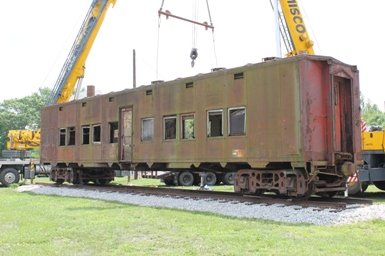

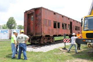

Adding a couple pics of what we got when it got here.
Thanks again!
Bill
