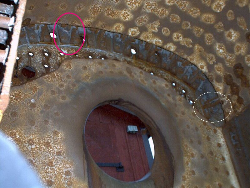

I'd like to add a pair of photos that will hopefully help clarify some parts of the braces under discussion. This shot is from inside the firebox of C&NW 1385 and you can see that the firebox doorsheet knuckle has been removed so you can see inside the water space. In the shot you can see 8 clevis's (sp) riveted to the backhead. I've circled a 4 rivet clevis and a 2 rivet clevis.

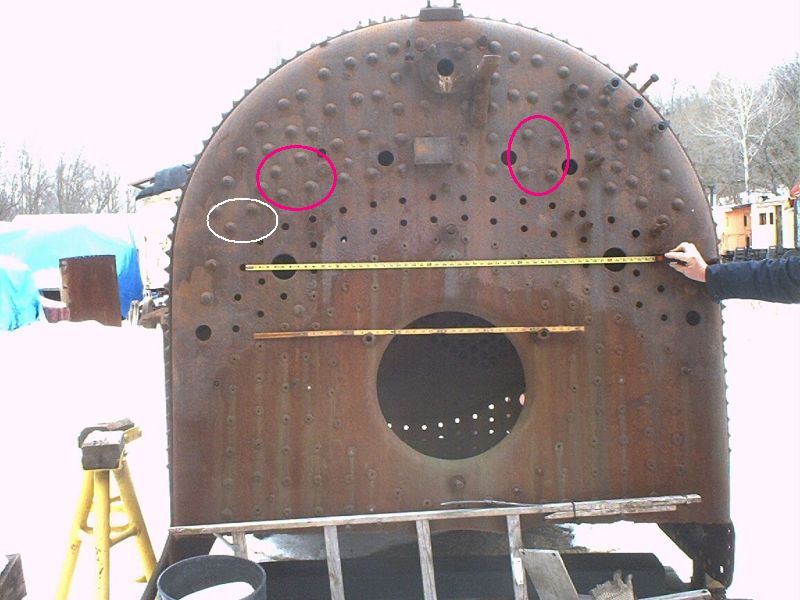

In this shot I've circled a pair of the 4 rivet and the same 2 rivet from the outside. Using a bit of imagination you should be able to see the pattern of the bases and get a handle on how many braces have been applied to this section of the boiler.
The surgery applied to the boiler took place in the late 90's (prior to current Part 230) while the vessel was under the jurisdiction of the state and we were working to satisfy the State Inspector.
