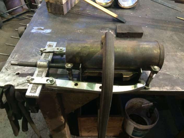

We recently replaced all four wheel sets under the tender of our Baldwin 2-8-2 #70 (ex-Polson Logging Co., 1922), during which we re-poured and machined all of the bearing brasses to fit the new journals. I've attached two photos to give you an idea of how we did it.
The first photo shows the mandrel arrangement. The outside diameter of the pipe is slightly less than the journal. It has four adjustable feet so that it can be placed squarely over the bearing brass. The mandrel is set high enough off the brass to allow the new babbitt to be thicker than necessary so that when it is machined to size, any imperfections in the babbitt surface are removed. I should note that we melted out all of the old babbitt and ensured the bearing brass was very clean before setting it under the mandrel. Both ends of the brass are dammed off with sheet metal and held in place by the large gear puller. A large C-clamp is used to secure the mandrel to the steel table. Babbitt-Rite is then packed in around the ends of the brass to fill any gaps.
The bearing brass is pre-heated at the same time the new babbitt is melted in a ladle.

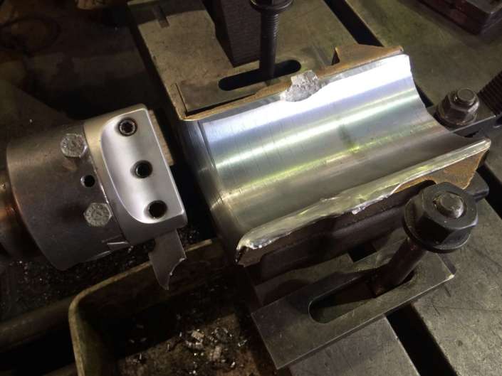

After each bearing was poured and allowed to cool, they were set up in our Lucas horizontal mill. I previously machined a spare bearing wedge (adapter) so that it was flat and square, and secured it to the mill table first so that I didn't have to indicate in all eight brasses separately. This certainly saved a lot of machining time. Each bearing was first machined with an appropriate cutter to get the diameter correct (journal diameter plus 0.015"). Each bearing had 0.25" of babbitt remaining which should allow for many years of service. After boring, the cutter was replaced with one matching the radii of the journal at the wheel hub end, and the inside end of each bearing machined accordingly.
I should also note that the longitudinal edges of the babbitt in each bearing was chamfered in the mill to allow the journal oil sufficient space to wick up under the bearing. Lastly, I used a bearing scraper to do final clean up of the babbitt.
I'm sure there are other ways of getting the job done, perhaps some that are quicker or more efficient than how I did it, but the end result is what matters I suppose.
I hope this was of some value to your project.

Very nice explanation and very nice work.
