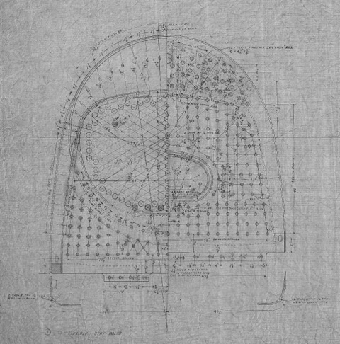

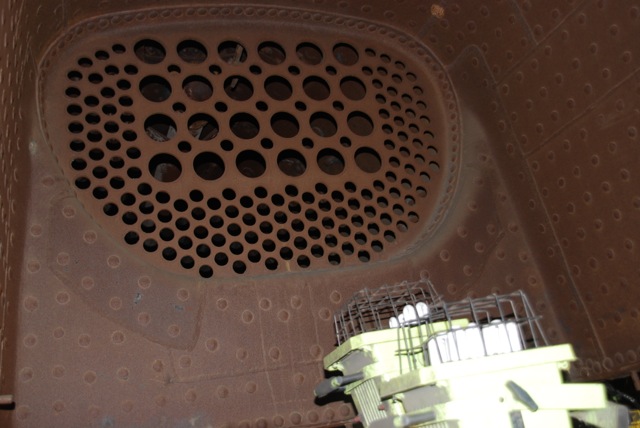

Interesting to see how different railroads modified their motive power from saturated to superheated steam.
Below is a 1903 drawing of the back end of the boiler of the soft coal saturated steam 2-6-0 500 series fast freights of the Delaware, Lackawanna, and Western Railroad, showing the original tube configuration.
Below that is a 2012 view from the inside of the firebox of DL&W 565, a 2-6-0 which was built by ALCO Schenectady in 1908, and so it is a locomotive of similar vintage to that of C&NW 1385. This picture shows the tube and flue configuration the DL&W selected when upgrading the locomotive to superheat and piston valves sometime around 1918.
Boiler 550 Class (DL&W 550 to DL&W 564) Sept. 1903.jpeg [ 94.18 KiB | Viewed 9419 times ]
