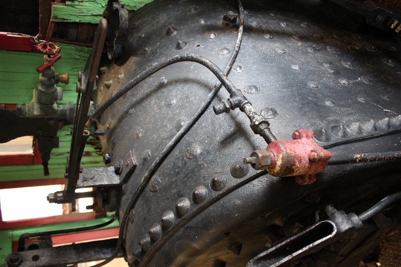

The locomotive will weigh about 45 tons in working order, the tender will weigh about 3 tons when loaded, and that is with the 2" thick steel plate floor that I added for weight.
The valve I am looking for is similar to this one on the tank engine at Altoona. I am sure that one must exist somewhere that would be available. I'll keep looking.
