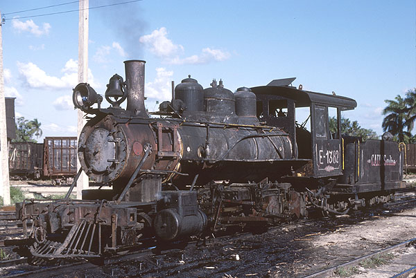

Cuba was the scene of the last (known) boiler explosion in the world.
It occurred in March 2000.
Loco was 1382 a Baldwin at the AC Sandino sugar mill.
TH

Trevor -
For the record:
Number 1382, a 3' gauge 2-8-0, Built by Baldwin in 1915, s/n 42690.
Again, info from Mr. Hungry Wolf's booklet. He states that the 1382 was built as Cuban Central Railroad #7.
BTW, you state that the explosion occurred in 1990. Adolf Hungry Wolf's book was published in 1996. Might you have the date wrong?
 Post subject: Re: Cuba
PostPosted: Fri Dec 19, 2014 7:28 pm
Posts: 332
I believe that the explosion of #1382 (2-8-0) took place in March 2000.

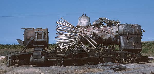

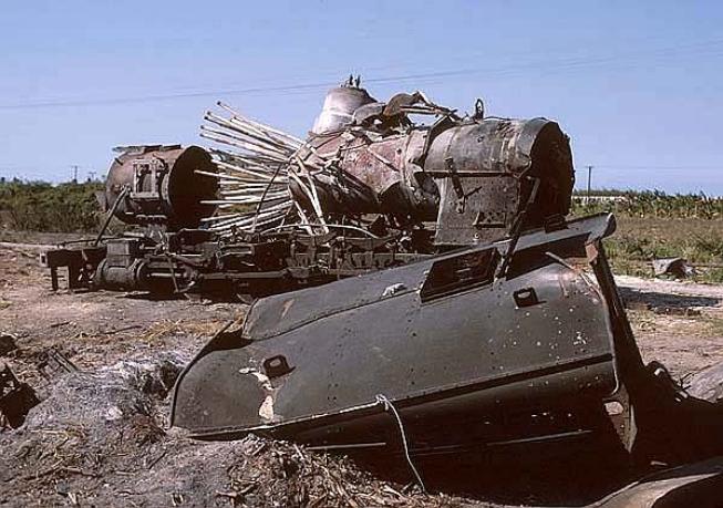

Sorry for the typo......the Cuban Boiler Explosion was March 2000
Here is an image of the loco from 1997 and a side view of the exploded engine

Anyone know what was the exact cause of the boiler explosion? Because of the displacement of the smokebox and the fragmented flues, it appears the blast occurred at the front of the locomotive, which makes me believe it was not the result of crown sheet failure.
Sorry if this has engine's incident been discussed before but I am unaware of its history.
PostPosted: Fri Dec 19, 2014 9:21 pm
Posts: 301
Location: Lawrence, Mass.
Weld failure on the front tube sheet, if I remember correctly.
