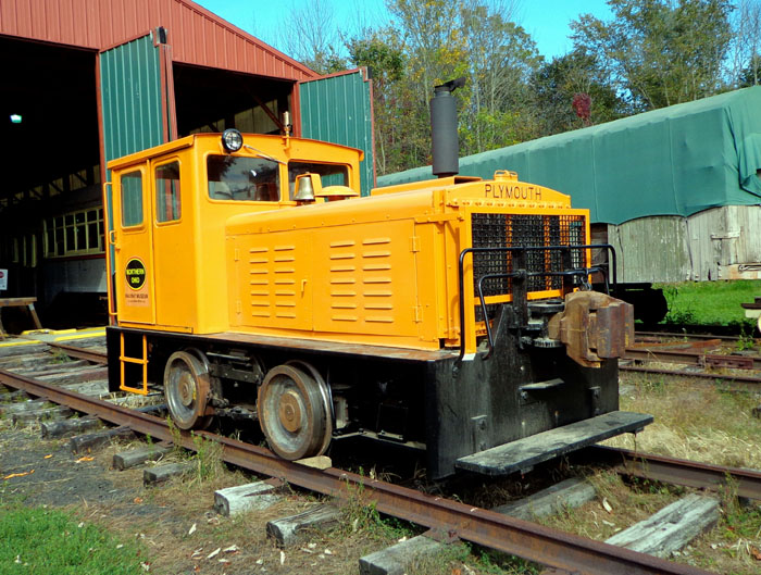

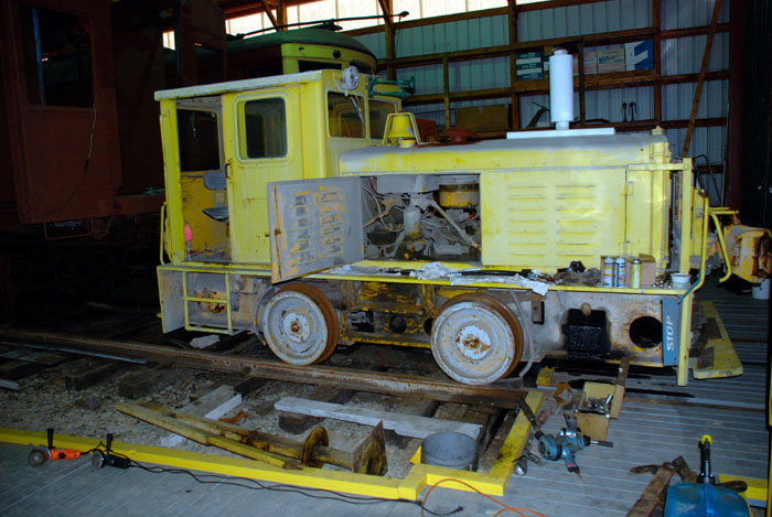

1. The rehabilitation of our 10 ton Plymouth locomotive. This Model DDT diesel hydraulic locomotive was built in 1960 by Plymouth Locomotive for the Dundee Cement Company. It has a Detroit Diesel 4-71 engine coupled to an Allison model TCD535 transmission. Brakes are straight air with a B-W TU-FLOW 500 air compressor supplying air. It worked at the companies Independence, Ohio transload facility. Here RR covered hoppers of cement were transferred to trucks for shipment to concrete batch plants in the region. In 2011 it was retired by corporate successor Holcim (US) Inc. It was donated to the Museum in 2012.
Then we began rehabilitating it. Its mechanical systems were serviced and repaired as needed. It had its brake system completely rebuilt including new brake shoes. Inoperable systems like the bell, horn, and lighting were restored to operation. The horn was replaced with a whistle, we are a trolley museum! The entire body was needle scaled and wire brushed to remove a very resilient coating of hardened cement. It was discovered the body had practically no rust. Perhaps we should be covering our cars in cement to protect them! Finally it was primed and painted in traction orange and gloss black. This locomotive now does 90% of the car switching needed at the museum, Only the heaviest items get the services of our other car mover, Cleveland Railway Crane 0711. Below are before and after photos.

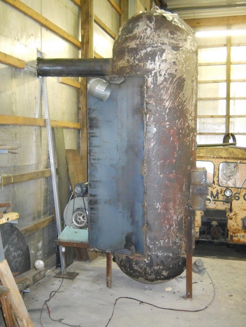

9. Surplus 500 gallon LP gas tank converted to wood stove for West Shop (photo).
