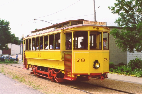

What was the HP on the motors of the Brussels trucks? I've had a pair of the controllers in my warehouse and they are HUGE. Ed Landrum had one of the trucks for decades before it was sold recently and it also seemed disproportionately large.
Our Museum used one of the Brussels-Brill 21-E trucks when we restored our 1893 Duluth single trucker No. 78 back in the early 1990s. I was told that the motors in these trucks were 75-hp each. Why so large? As the story went, these Brussels cars were designed to haul 1-2 trailers and the routes they were to operate on involved some hilly terrain.
Our No. 78 is certainly a peppy car with those big motors, even when we have the K-10 controllers pegged so that it can't get out of the series notches.
