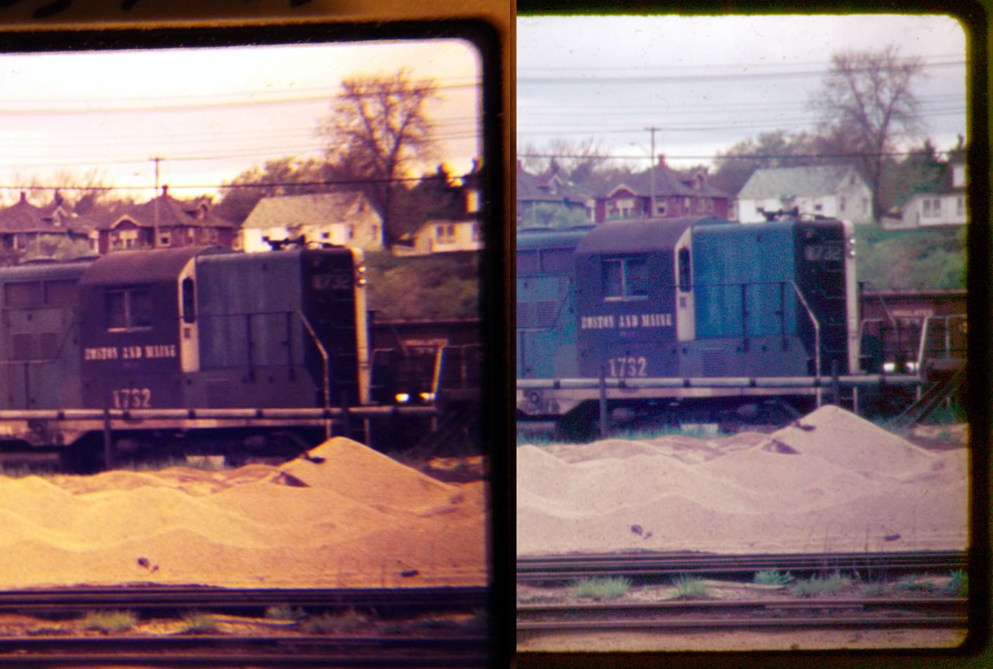

I'd recommend against using a digital camera to duplicate slides or other transparencies.
If you look at the image supplied below, the right side was scanned using a Microtek 9800XL at 1000dpi, the right side was using a Fuji FinePix S9450W digital camera using their "super macro" (1cm) focus capability with the slide on a light table using whatever florescent bulb that is in there.
Both images had their color/brightness levels done on Photoshop Elements using its auto level feature. Having the color balance off on the left is not to big a problem to correct.
The major issues are the pincushioning from the camera lens and some softness. Also the light saturation/contrast on the left image is more extreme The resolution seems about the same.
The other item is that the digital image is 72dpi from the camera, even though it is 4806x3456 pixels vs 2136x2000 scanned at 1000dpi. A little math tells me that there is an order of magnitude difference in information per pixel being captured between the two.
Given the work needed to correct the camera image, I'd stay with the scanner and just budget yourself accordingly.
Granted, shooting 1 image is quicker than scanning the slide, but you can scan in 6 slides (on a 12" wide bed) as quick as 1 can be & then use Photoshop to split them up.
The Microtek does supply a slide mask & software to create slide scans, but I misplaced it somewhere & couldn't use it in the test.

Textbooks have been written all about the proper temperature of light for color reproduction. My wife, an artist, has them, and she throws fits over in what light she produces and displays her art. Suffice it to say "it's not that simple."
If all you were doing were re-shooting the original subject under the same sunlight as the original photo, that might suffice. But we're dealing with slide and negative films, each with their own known variations in reproduction, which are made to be exposed and projected with specific lighting requirements. Then you introduce a new factor by attempting to reproduce it digitally. All light, even all sunlight, is not created equally.
Part of the point of a slide scanner is consistency--you eliminate one potential variable by having the same light, diffusion, etc. no matter what you feed in.

Actually, using a high megapixel digital camera to digitize slides and negatives is not only possible, but if done carefully, can rival the results from dedicated film scanners.
Take a look at this link:
http://www.luminous-landscape.com/essays/scannerless_digital_capture_and_processing_of_negative_film_photographs.shtml
The article deals with primarily negatives, but if you look at the PDF download in the article, you will see the setups the authors used. You could use any film type and adjust your process to fit. The primary thing to note is the authors used proper macro lenses optimized for shooting at close distances. If you slap any old lens on your digital SLR, your results will likely not be as good. The best method would be the use of a top quality enlarging lens with one of the slide duplicators of the past. Since digital cameras can adjust to most any light source by changing the color temperature, matching the color on slides should be easy. If you read the entire article, you will see that negatives are not as easy due to the masks they contain.
I have not tried this myself, but I'm considering it for 35mm slides. I own Nikon 9000 and Epson V750 scanners and while the scanners produce superb results, my chief complaint is the slow speed of scanning.
