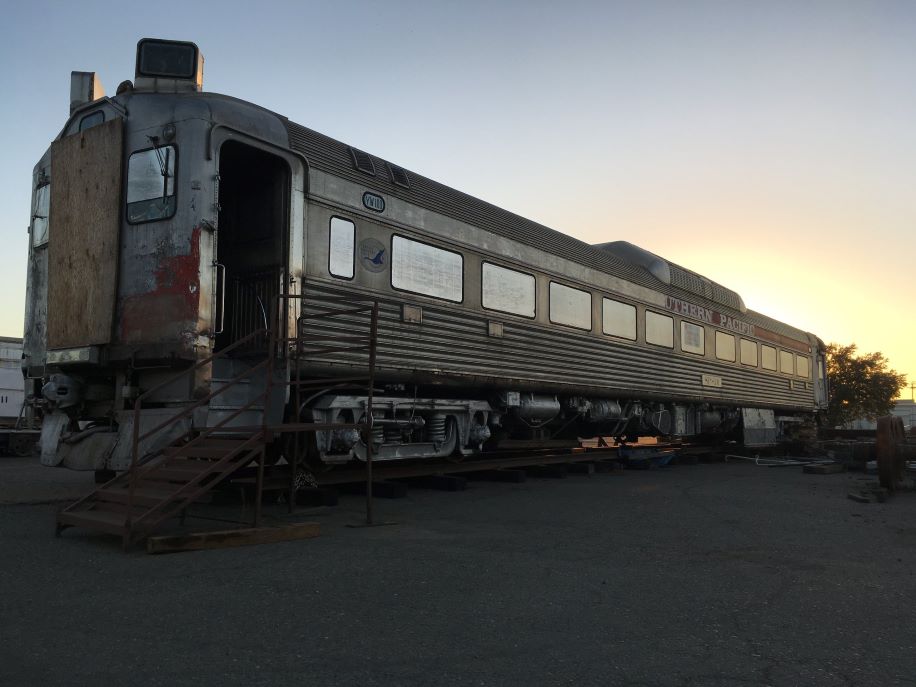

BTW, this car still exists, it was flooded while preserved in Galveston TX but a group in Woodland CA is restoring it, here is was in 2018, from the "RDC SP-10" facebook page.
