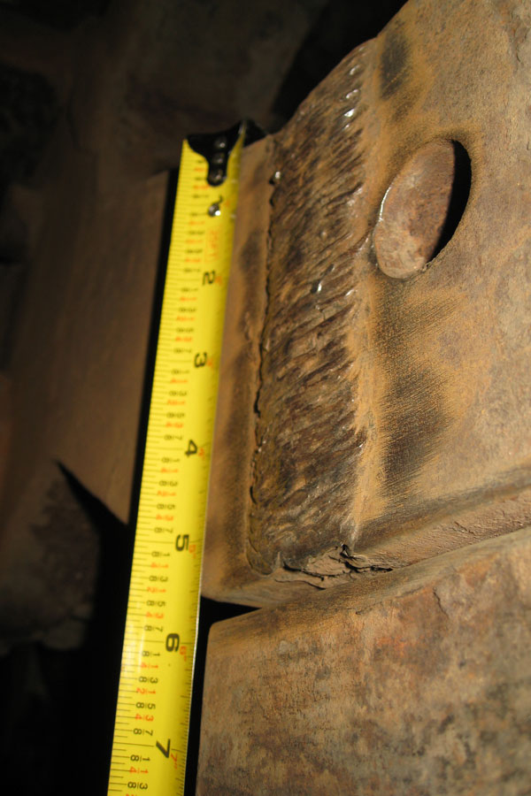

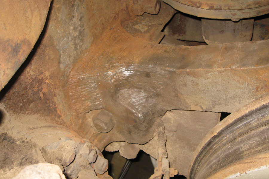

Referring to the drawing in my original post, here is a photo a weld. I’ve got seven to upload, but I’m not sure how the size is, so this one is a trial.
This is weld #1. It has a crack in the weld, extending below the weld on the inside of the frame, fireman's side.  The crack starts on top, and extends through the oily spot. This is immediately behind the cylinder saddle.  Note the "filler" that has been welded into the "V" part of the frame.  This filler is not present on the engineer's side. Photo taken looking up from the service pit, looking at the inside of the frame.

Sorry, I cannot really place the weld compared to your first posting as #1.
Apart from that regarding the filler plate welded in the triangular hole, is it
welded in fully, closing the hole, or only partial. In the last case, does crack #2
start from there? An extra picture would help.
Kind regards
Jos Koopmans

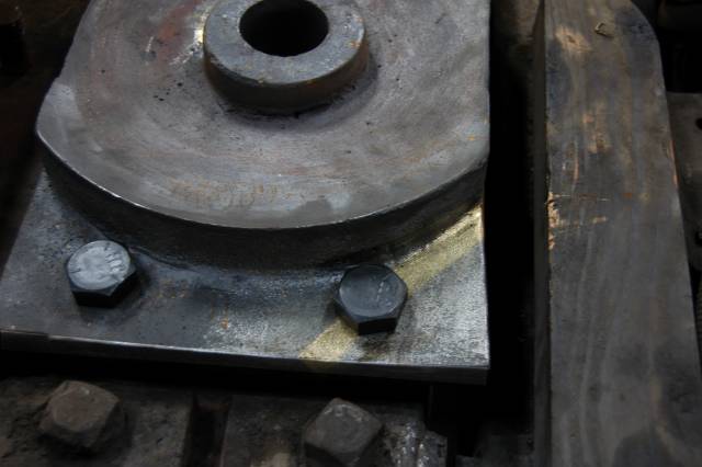

Actually, several of our recent repairs at Lock-N-Stitch have been furnace brazed rather than welding with a ferrous filler.
Here is a cracked center plate from Peninsular Railway interurban 52 after they repaired it.
Al Stangenberger
WRM
File comment: Peninsular Railway 52 center plate

Al, very nice brazing repair on that center plate. Thanks for the picture
Brazing is technically not welding (lower temperatures involved), the base metal is not melted.
Brazing cracks on the exterior of cast iron is very feasible. Doing it in a furnace makes the temperatures more even and the stresses are lower.
In that center plate the loads are mostly compressive; car body pressing on center plate pressing on truck bolster. There might be a little tension when the car body shifts sideways and pulls the truck bolster with it. But with 4 bolts at any given time at least two of them are being pushed against (compressive stress)
The filler metal used in brazing is usually not as strong (20-40 kpsi) as steel (40-100+ kpsi). The filler material used in welding can be as strong or stronger than the base metal being welded.
Welding (where the cast iron is actually melted) on cast iron (especially cracks inside, not on the perimeter) is very difficult.
Brazing cracks in an engine frame is probably (my opinion) not strong enough.
Brazing a doubling plate (in parallel with the frame, over the cracks) might (repeat might) be strong enough, but some careful analysis would be needed.
Cheers, Kevin.

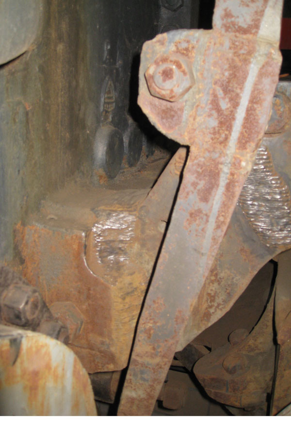

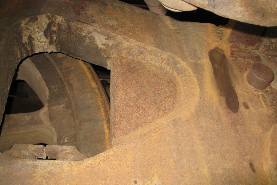

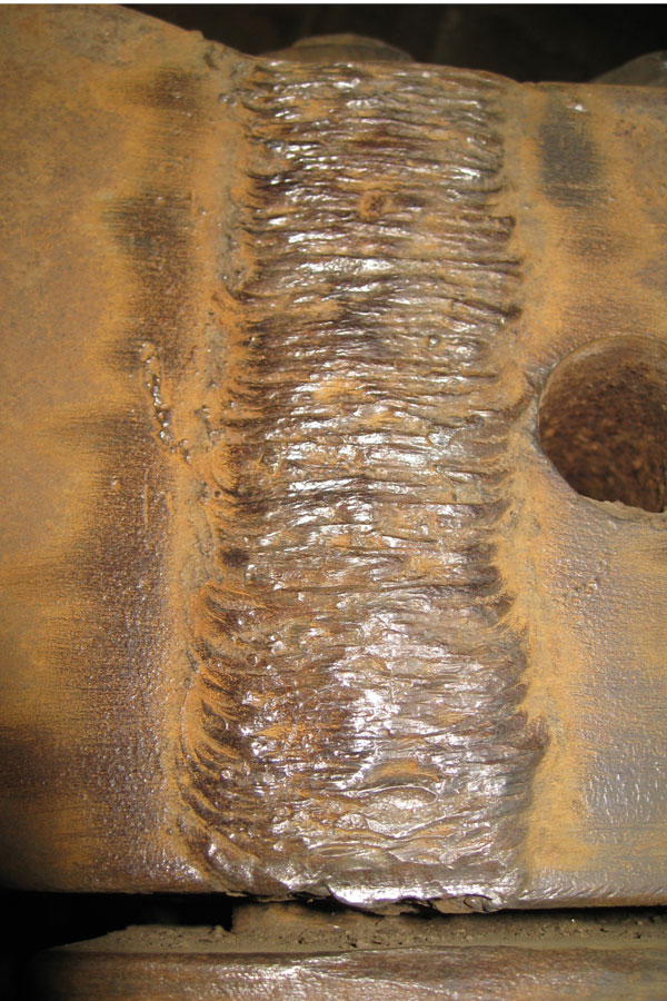

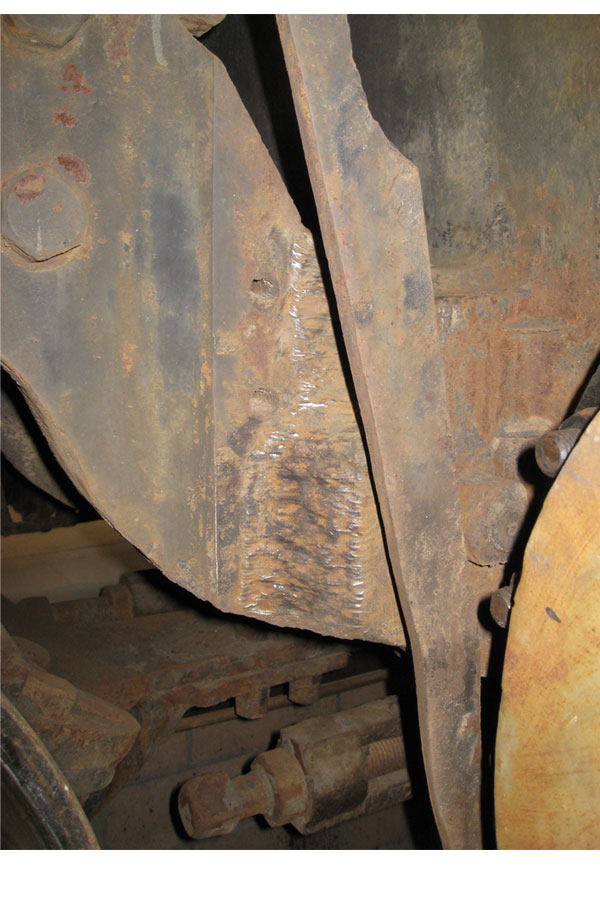

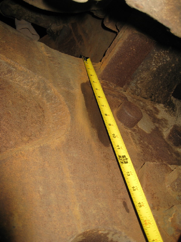

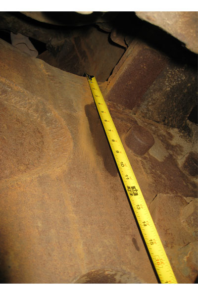

Here’s the whole series of photos. Refer to the drawing in my original post for locations. The 4-digit numbers are the main portion of the photo file numbers; all have a (dash)_3 suffix.
6311 & 6313: weld #1. It has a crack in the weld, extending below the weld on the inside of the frame, fireman's side.  The crack starts on top, and extends through the oily spot. This is immediately behind the cylinder saddle. Note the "filler" that has been welded into the "V" part of the frame.  This filler is not present on the engineer's side. Photo taken looking up from the service pit, looking at the inside of the frame. The weld is hard to see; it starts just under the top of the tape measure, and extends left about 3", it comes down about 6".
6315: Also Weld #1. View from outside of the weld in 6313, looking down across the #1 driver. The weld extends onto the cylinder saddle. Crack, not visible in the photo, extends across the top of the weld, then down the inside of the frame as shown in 6313.
6304 & 6305:  Weld #2, engineer's side, at the most forward bolt hole for the front axle binder. Looks like there might be a crack showing just above the binder. Photo taken looking up from the service pit, looking at the inside of the frame.
6317:  Weld #3, fireman's side, just forward of saddle. Photo taken from outside, looking between front of cylinder and pilot wheel.
6319:  Welds #3 and #4, engineer's side, just forward of saddle. Photo taken from outside, looking between front of cylinder and pilot wheel.

Total of 7 pics. Here's another 3.
 Post subject: Re: Frame Welds
PostPosted: Tue Apr 22, 2014 10:20 pm
Posts: 269
Location: San Diego area
Here's the last

Thanks for the additional photo's. Actually those repairs look pretty good compared to ones I am thinking of. Way better actually. Let others chime in on this.
My welding on frame experience was more restoration of the jaws and wear points rather than repairing of broken sections. But thoroughly enjoy the subject matter.

Thanks for the pictures. It looks as a proper welding job. However, if all of them show cracks, the probable cause is welding without preheating. Moreover this way of "weaving" vertical (?)welding induces a lot of very local heat and the result was probably never X-rayed. As for picture 6313, it confirms my fears that such a partial closure of the hole causes shrinkage problems probably contributing to the crack next to it.
If it were my frame, I would remove the welds ( I don't know the english name) by electroflame cutting with air. All welds horizontal by rotating the frame and use two welders to get a symmetrical shrinking weld.

I trust that those areas that look like hellacious HAZ are just 'overlap' from the wire wheel or whatever was used to clean and brighten the weld beads.
If this were mine, I'd have someone do a good NDT (perhaps X-ray) examination of these welds. You might even get the service wholly or partially donated -- this sort of thing is excellent PR. That will give you a good idea of what might be required here.
If you want to check some of the procedures used in contemporary welding at the time this work was done, search on 'autogenous welding'. There is also mention of the process and its details in some of the magazine and journal articles, and some of the 'locomotive up-to-date' types of textbook.
If the welds have to be cut out, I can't help but wonder if there is such a thing as a portable waterjet cutting apparatus -- there's been enough heat thrown into that frame already, I think, to make plasma cutting a less-preferred approach. I would agree with Jos on downhand welding if it is convenient to rotate the frame, BUT I can't help but wonder about the likelihood of warpage or even additional cracking when the frame is rotated out of plane with one or more welds cut out, with this many welds and so many proven cracks.
I'd also add that the frame be preheated properly for each weld, that perhaps one of the submerged-arc processes (with flux) be used rather than using gas blanketing, and that some kind of positive jigging be provided to keep the frame correctly aligned during the entire process (preheat, weld, aftertreatment).
