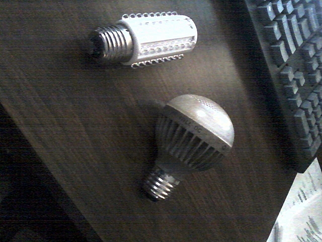

Here is a picture of the current varieties the railroads are using. One on the left is for walkway and number board applicatons. The one on the right is for the step lights and for over the trucks. Left hand bulb puts out light radially to the bulb, right hand bulb puts out light from the end of the bulb only-like a spotlight. Both are bright white light and are labeled "Railheadcorp.com" for the manufacturer.
Forgot to add..they can stand to be exposed to voltage as high as 115 with no damage. They blink on, then go out. They'll come right back on at a lower voltage. Very tough.
I have a feeling they are very expensive, but the railroads are switching everything over to them. I have never came across one that is "burnt out". They are tough and, except for the harsh white light, would seem to be the perfect fit for all your lighting needs. Sounds like some applications call for the dull yellow of the incandescent, and may not look proper with a stark, bright white lamp.

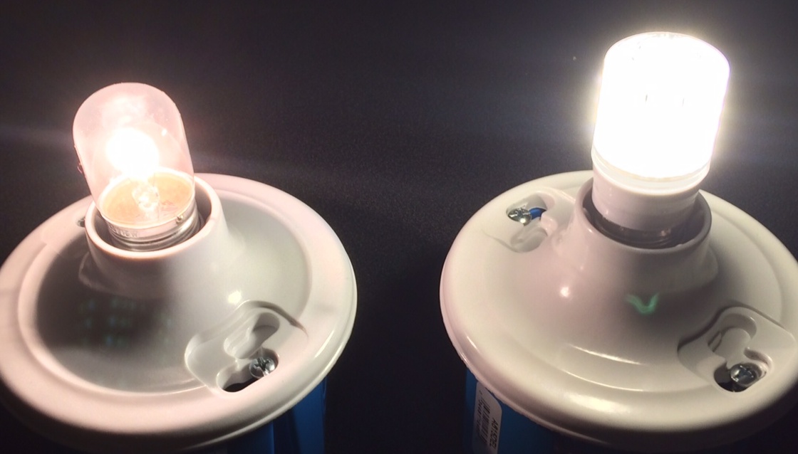

When I had these bulbs made, one of the key specifications (for me at least) was to mimic the color temperature of an incandescent bulb as closely as possible. This is a side-by-side comparison of an incandescent bulb (left) and the LED bulb. The LED bulb is both brighter and whiter than the incandescent, but in this case at least some of the "whiteness" is the result of a higher luminous intensity. The bulb illuminated the water glass quite nicely, without the harsh starkness of a typical LED light.
The Railhead bulbs, while fine for number board illumination, would not be ideal for water glasses, gauge lights, etc. These bulbs produce about 270 lumens in the cool side of the color spectrum. They are doubly hard on the eyes with the brightness and the starkness of the light. The bulbs I had made put out around 160 lumens, and while a bit whiter than an incandescent, the light is not at all hard on the eyes. I installed one in one of the water glasses and while noticeably different than an incandescent, it is quite easy to become accustomed to them. If all of the bulbs in the cab had been replaced with these LED you would not have even noticed the difference.
