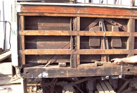

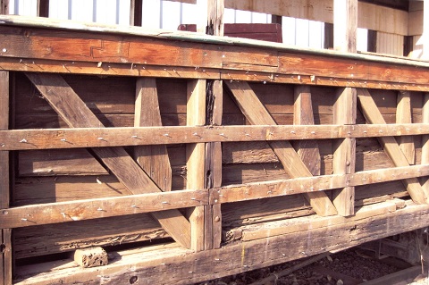

Suppose its time to chime in as well, my Pullman at 56ft has the long iron truss thru the belt rail, so did the C&S 529 65ft built by St Charles in 1900, also interestingly it looks like 'Omaha' the 1866 Wagner sleeper / C&S car 54ft has that pattern too.
Picture of our framing here
http://car57.zenfolio.com/p331500692/h1 ... #h123b6657
Mike Pannell
