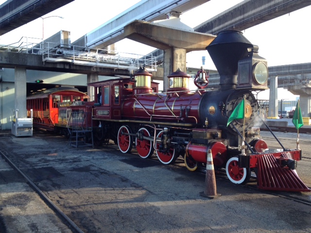

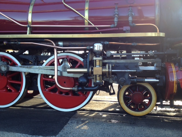

I may be confused in what we're actually talking about, but I don't see the equipment I'm thinking of in the photos of the Disney locomotives as delivered from Mexico. Here are photos that I took last week of the Walter E. Disney in front of the WDWRR roundhouse. They have two of these ten-wheelers that they call "The Twins". Both have similar set-ups. I did not get a good look at Roy O. Disney (4-4-0) and don't recall seeing a similar system. Lillie Belle (2-6-0) is currently off the property for major repairs (frame issues, I believe) making it unavailable to view.

PostPosted: Tue Mar 11, 2014 12:29 pm
Do we agree these pumps look like modern builds from bar stock?
That would be consistent with the information provided by the fine Disney folks.

The crosshead pumps, like many of the other goodies, may have been removed from the Disney engines prior to shipment, so their not appearing in photos is inconclusive.
I don't believe any of the current cast members were involved with the engines' rebuilding, which was done at a Tampa shipyard, so I would take what they have to say with a grain of salt. The gentleman overseeing the rebuild by Disney, Earl Vilmer, was a former KCS roundhouse foreman before WWII, and a very knowledgeable railroad veteran, having oveseen the construction and operation of the supply rail line through Persia during WWII. He was also the guy who oversaw the buidling of the original Disneyland engines, and the re-building of the two later Baldwins. None of which have crosshead pumps. I doubt he would see fit to use crosshead pumps if the engines didn't already come with them.
The feedwater heater was designed and constructed by the foreman in the Tampa Shipyards, George Britton. After the rebuilds, he was hired by Disney to be their roundhouse foreman in FL, where he worked for several decades before retiring. The feedwater pump can be seen in the second photo by Mount Royal posted above. It is the cylindrical tank immediately behind the crosshead pump and first driver. I don't have mechanical details, other than that steam (possibley exhaust steam) fills the tank, and as the pump is operated, the feedwater flows through the heated tank and is warmed.
The WDW crews do indeed prefer to use the crosshead pumps over the injectors.
