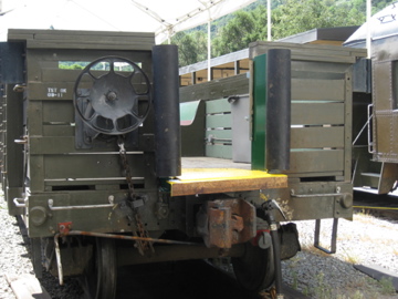

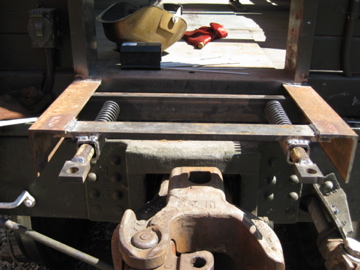

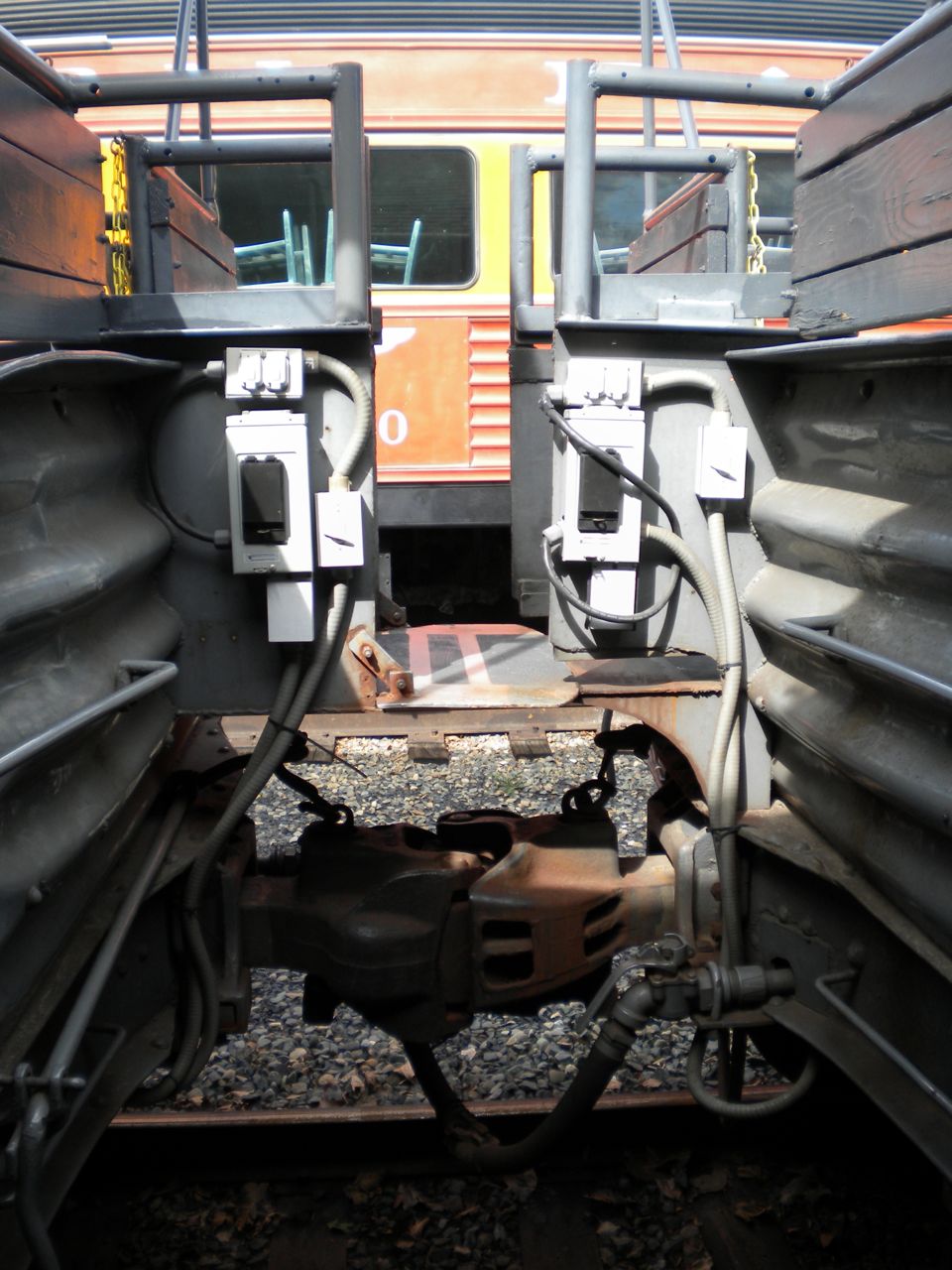

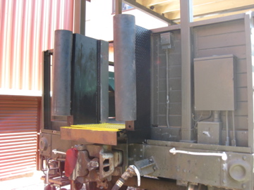

On the Niles Canyon Railway we have three flatcars converted for use as open cars. We used park benches for seating and built roofs over two of the cars. All of our open cars and cabooses are operating under a FRA waiver since they are over 50 years old and earn revenue. Attached are a couple photos of the diaphragm mechanisms I built so the cars can safely allow passengers to walk from car to car.
Johnathon Kruger
Road Foreman of Engines
File comment: NCRy "Chapel Car" diaphragm
File comment: NCRy "Park Car" diaphragm
File comment: NCRy buffer system

Among other railroads using flatcars modified for passenger use include the New Hope Valley RR at Bonsal, NC, which has two or three ex-DOD heavy-duty flatcars so modified and Cass Scenic in West Virginia.
That bi-level auto rack, at the former Gettysburg Railway, is for sale, last I knew. When I was working there some 12 or 13 years ago, we rebuilt the car's trucks with new snubbers, which improved the ride greatly.
The WK&S gons -- there are two though only one is in service -- have served well ever since 1964, with minimal expense and upkeep required.

I recall looking at the converted gondolas used by the Sacramento Southern operation of the California State RR Museum. If I recall correctly, these were first converted by the Sierra Ry back in the 1970s. And then probably upgraded over the years.
Similar to the PLA, Niles Canyon cars there is a canvas roof structure made out of tubular material. The canvas covering was carrying a tag from the supplier (probably a commercial tent maker) that noted the material was water and fire proofed.

I wouldn't even attempt the "proper buffers" like NCRy/PLA did. You don't have time, unless you can assign a spare crew specifically to that task. Maybe a Cass sort of deal where the walk-through is a "bridge" (with sides) that has one foot on either car.
Here's what CSRM did, now that I look at them, I'm not a fan. They have to leave that good 6-8" gap for slack action, you really don't want your walkway carrying buff forces. At the least, I would close that gap with cloth, rubber, brush heads (let the bristles intertwine) whatever you can get.

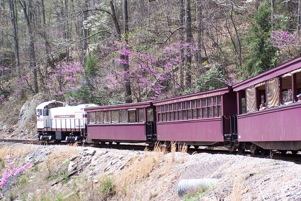

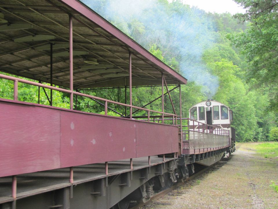

Big South Fork / K&T operates a variety of cars, all built on flat cars. I know that original post references a gondola, but these are given for reference.
1) Open car: pipe rails, nylon mesh sides, pipe seat frames, treated wood bench.
2) Covered Open Car: Same as above, with a roof framed with pipe, and plywood sheathing, rubber roofing.
3) Open Window and No Window "Passenger Cars": Built with wood bodies, based on Cass Scenic design, modified. Walkover seats installed from old coaches. Two cars have wood frame windows that raise, while two have open sides with roll down plastic for cold weather.
Loading is from raised platforms, with drop down gangplanks from end vestibules.
