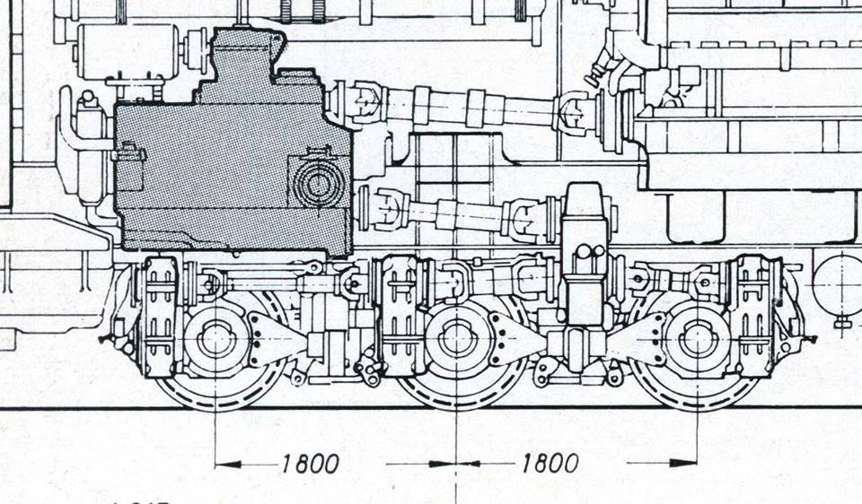

The company who originally provided the cardan shafts to Krauss Maffei is still in business and can make them for us. In fact, we have a quote from them for the construction. This will be our next fund raising effort. Unfortunately, due to the torque that must be transmitted during engine cranking (the starter motor is on the transmission), their length and the high engine horsepower, the requirements for the shafts are quite stringent so we have decided against trying to modify any existing industrial shafts.

Is there a diagram somewhere that shows the arrangement of the gearboxes and shafts? Didn't see anything on the restoration web site that would help me understand the power transmission arrangement.

Is there a diagram somewhere that shows the arrangement of the gearboxes and shafts? Didn't see anything on the restoration web site that would help me understand the power transmission arrangement. Will be watching for future donation opportunities!
This should help. I will see about adding some technical information to the web site.
