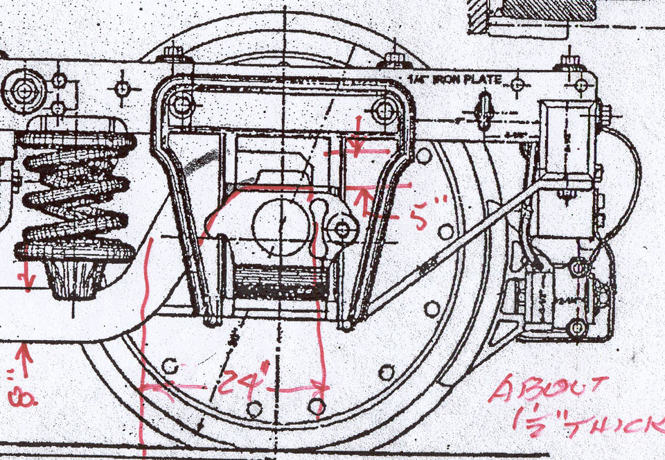

Here is a reply I received yesterday from a volunteer researcher at the Colorado Railroad Museum:
There is a book published by the Museum as Colorado RR Annual Bulletin #25. Title is "Rio Grande Narrow Gauge Varnish". Author is Herbert Danneman, had 325 pages, hardbound, photos on almost every page. This book catalogs photos, drawings, builder, cost paid, year built, and year scrapped or sold for every known D&RGW and RGS passenger cat known.
Searching it I can find no reference to any L&C or ET&WNC cars that might have been purchased from either of those railroads.So far as the data shows, the D&RGW only purchased two passenger cars form any other railroad, and those were from a DRGW owned line in Utah. Everything the RGS had except for one or two cars came from the DRGW.
But the DRGW did build some baggage and other cars in their own shops and it is possible that they may have purchased used trucks from a dealer in used railroad parts....ot possibly from the L&C or ET&WNC of those companies advertised they had parts for sale in Railway Age or some other journal.
I have Attached a scan of a drawing and in examining it certainly seems that your piece could be part of an equalizer bar, although I still think it would be unusual to find that part as a casting. It should be about 1 1/2" thick.
We have all the reference books and others that list all the cars and locomotives a railroad had in any year. But these would not give detail beyond numbers of locos and cars types.
You could, of course, contact the people at Durango but again it is virtually impossible they could provide any detailed history on such a part. After a period the railroads simply discarded the huge quantities of paper work, cancelled checks, and even personnel records due to the huge accumulated volume.
Chuck Yungkurth
Library Researcher
Signed, Brooks
P.S. In reply to why would a 29 mile railroad have a flanger: they primarily used flangers for ballast work on the D&RGW, but also used them for snow work.

Brooks Wilson wrote:
All,
Chuck Yungkurth
Library Researcher
The owner mentioned the part being a casting. We need to confirm whether or not it is a casting. This conclusion cannot be drawn from the photo. I wonder if such equalizer bars were ever cast in the early days of this artifact. One big clue would be the appearance of the broken faces.

In a message dated October 25, Mr. Wilson tells us the piece is between 1/4 to 1/2 inch thick. If it's a portion of an equalizer bar, someone has done a lot of work with a file.

That information on the thickness raises a discrepancy for which we need more information to resolve. As I mentioned earlier, it cannot be an equalizer bar if it is only that thick. But Mr. Wilson has also stated that the estimated weight is 40 lbs. By the photograph and dimensions given, I estimate the profile area to be 1 sq. ft. So that would be 1” thick if it weighs 40 lbs.

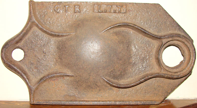

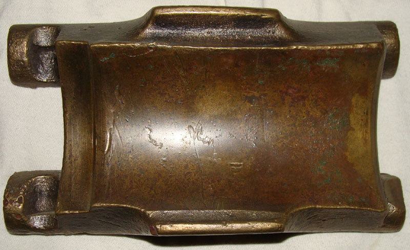

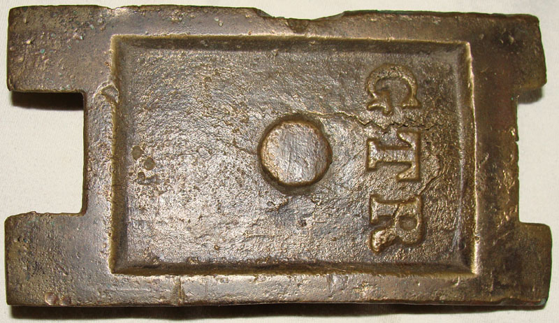

Something different. Doing some tidying today and came across these. I picked them up at an old wreck site many years ago. Just thought they might be of interest? They are both marked GTR for Grand Trunk Railway. The site was on an abandonned right of way that had been the Great Western Rail Road (of Canada) Hamilton to London main line and was later GTR and used as a spur by CNR until about 1963.
Journal cover is approx 13" long and 7" wide.
Bearing brass is approx 7" long and 4" wide.
All the best.

Great Western,
Those are really nice artifacts. I wonder what era they date from. I would guess they are pre-1900. Were they buried at the site or lying on the surface?

Posts: 445
Location: Ontario, Canada.
Mr. Travis,
The former owner of the property had done some digging and allowed me to pick over the area. This was something like 30 years ago.
There were an alarming number of wrecks in that area, including a passenger train disaster that killed 11 people in 1889.
We think this particular derailment was November 5, 1891 when two freights collided as newspaper accounts place it in the correct spot. If not, it was either 1901 or 1906!
Thank you.

Great Western,
If it is a wreck site, there are probably more artifacts buried there. I have no idea what the site is like today, but I wonder if it would be possible to do some metal detecting there. It is interesting that you are able to correlate a specific wreck to that site. There is always the possibility that the historical record and the actual site can yield details that mesh and reinforce each other. Generally, there were a lot more wrecks everywhere in the late 1800s. They all deposited iron and metal parts and fragments, many of which are there today.
