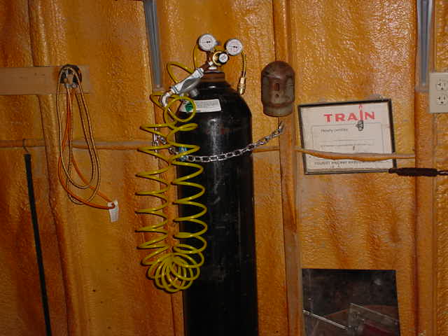

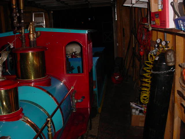

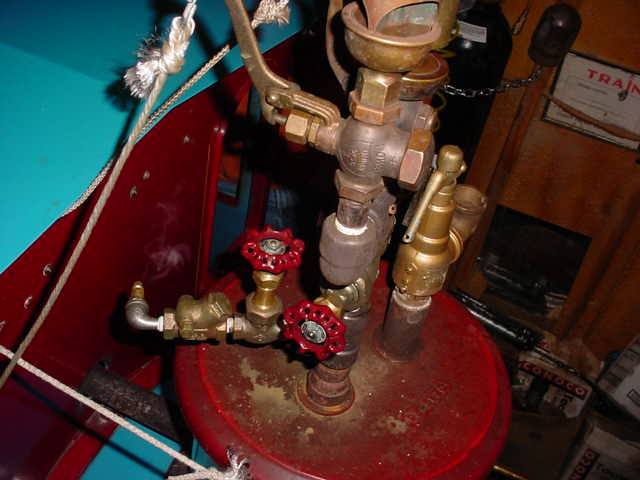

To illustrate a simple nitrogen blanket setup, attached are some photos of a 24 inch Crown. Being small, the boiler connections show on one photo. The tank has a first stage regulator down to about 20 PSI. The second stage regulator is an off-the-shelf propane regulator, factory set at 11 inches of water ( about 0.4 PSI ).
The connection is by a flexible air tool hose. The quick connection from the hose to the 1/4" check valve is a brass air tool connector. It won't rust. The " O " ring has been coated with silicone grease for protection. The nipples are schedule 80 and the valves are 300 WSP. The connection can be made anywhere above the water line, into a line that is not flooded.
An important detail is to have the connection to the check valve running downslope toward the boiler. If ( when ) condensation gets past the check valve, we do not want it forming a liquid trap in the supply line. This trap can prevent nitrogen flow. Let the condensation flow back towards the boiler. An experience-based improvement learned since these photos were taken is to use a Stainless Steel or hard copper tube condenser coil just prior to the quick connection. This cools any condensation quickly before it can back up the flex hose.
Nitrogen blanketing should be utilized only after a boiler has been steamed and vented, dissolved oxygen driven off.
The nitrogen should be applied when there is some low steam pressure present. Simply open the supply, verify pressures, make the quick connection and open the manual valve on the boiler top. The check valve will ( should ) prevent reverse flow. When the steam cools and the boiler starts to go into vacuum, the nitrogen pressure opens the check valve and nitrogen starts flowing. The nitrogen supply should be maintained until the boiler cools to 110 F. After that, the nitrogen supply can be shut. Standard procedures in industry include a 15 minute purge of the boiler weekly. Simply turn on the nitrogen supply for a while. I have often seen this automated with a timer and solenoid valve.
Proper safety practices include placing a sign at manholes marking the Confined Space and Inert Atmosphere. Check air quality prior to entry .
Full Coaches and Happy Steaming !
