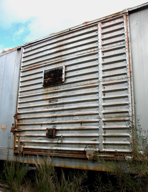

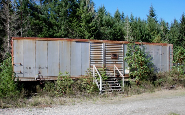

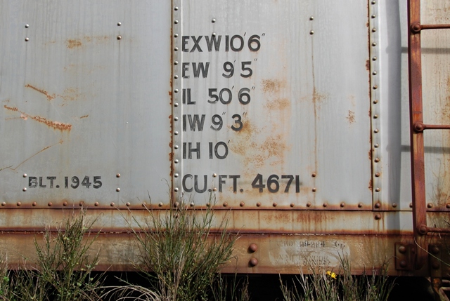

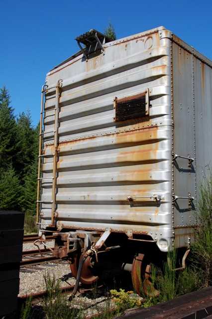

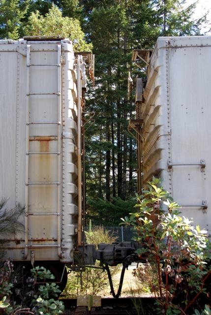

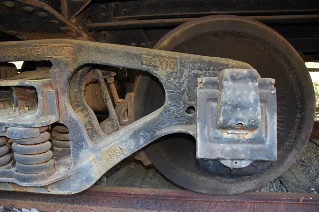

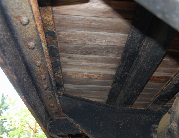

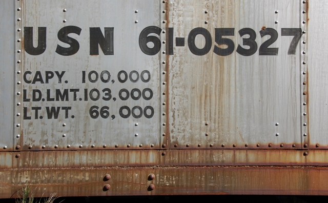

Here is some info and some photos of the 50' box cars at Bangor. I don't have any photos of the 40' box cars.

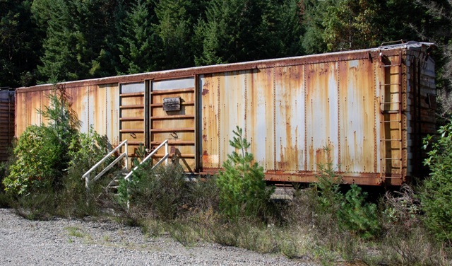

50' - newest ones were built in 1945 and the only builder identification I could find was on one which was still stenciled "Built by Pressed Steel".

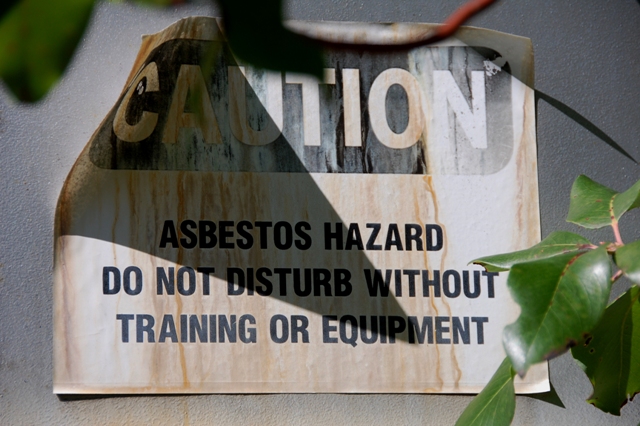

Exterior condition ranges from amazingly good to OK and a couple I looked in were in very nice condition. Some have asbestos hazard caution signs affixed. I couldn't speculate as to whether the Navy would abate any asbestos for the recipient - I would just pick a car that doesn't have asbestos.

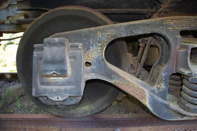

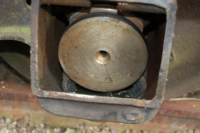

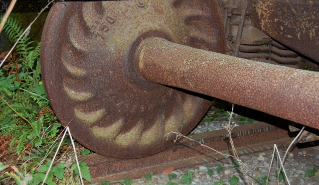

All but one have Gould TF-5274 trucks with plain bearings (5 1/2 X 10), cast iron wheels and USN cast into the side frames. (The odd ball is one car with a pair of Northern Pacific trucks. Were they replaced on an NP RIP track? Other than rolling over NP rails, the car likely has no other NP connection as it is just like all the others.) All appear to have StaPax Journal Pads installed around 1968-72. On some, the car oil looks like it was just added.

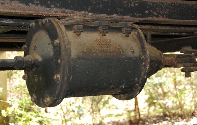

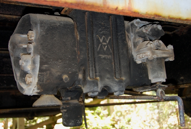

All appear to have Westinghouse AB brakes.
40' - These appear to have built by GATX and sport AAR 39 trucks with 5 X 9 plain bearings. I noticed some had a mix of Wabco and NYAB components.
At the very least, the Navy will move the cars outside the gate to an area which would be accessible by your crane. With about 30,000 civil service shipyard employees staying home every Friday without pay, I personally don't see how Uncle Sam could justify loading your car for you however, if you don't ask, the answer will always be no.
Even though this equipment would be obtained via Defense Reutilization and Marketing Service, your 501c3 may need to go through your State agency. For Washington, it's the Washington State Department of Enterprise Services. Through them, you establish your eligibility to receive Government surplus.
Good luck!
File comment: Exterior End Typical
File comment: Exterior Side Typical 2
File comment: Exterior Side Typical 1
