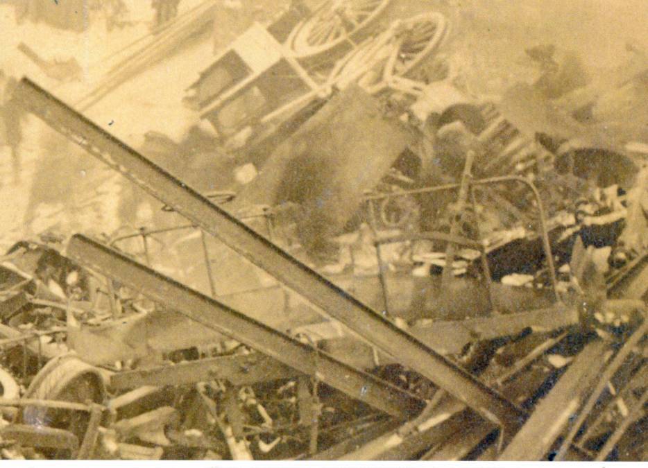

I would like to thank everyone for the help and discussion on the wreck and mention of the Miller platform hook couplers used on passenger coaches at that time. I have been scrutinizing all the wreck photo's that we have and only (1) shows the erie image of a lone coach end platform with brake wheel sticking up amongst the wreckage.
After zooming in and enlarging the photo i'm somewhat sure that it had the Miller platform hook type coupler. Although you can't really see the actual coupler due to the bridge iron blocking the view of the center area there is something else that stands out i hadn't noticed before. To the right on the railing is a angled somewhat vertical handle lever sticking up above the railing with a curved mounting bracket mounted to the upright railing posts.
This lever looks identical to the one on the Mid Continent Ry. Miller hook restoration page that shows the lever with a chain attached at the bottom going over to the coupler. I'm attaching a zoomed in wreck photo of this showing the end platform and railing and handle for others to also hopefully confirm.

The Miller coupler looked something like a HO gauge horn hook type. The couplers were held together by the hook, and by springs that pushed the side faces towards each other. To uncouple, there was a big lever on the car end that the brakeman had to horse over move a coupler. Sometimes there had to be a brakeman on each car to get the couplers far enough apart to make the cut. Those Miller uncoupling levers were unmistakable and a careful study of photos and what might have been found under the bridge over the years would be a sure sign the Miller was in use.

The Kuenzel post with the photo clearly shows the Miller uncoupling lever just right of center.
The train may have had both L&P's and Millers. Many Miller's had a slot cut across the coupler face to allow a link & pin tie up. The slot weakened any and all types of coupler knuckles, and brought some tightwad managers to the conclusion that the L&P was a better system; that is, if brakemen would be more careful in their work!

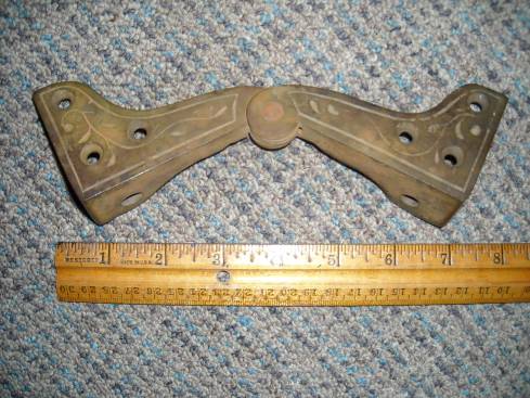

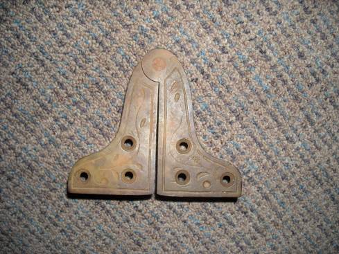

Does anyone recognize what this hinged brass pc. of RR coach hardware may have been used for on old RR coaches back in the 1870's? I found this complete one at the Ashtabula bridge disaster site a few years back but have also found a few melted 1/2 pcs. of some just like it. David Tobias has also found 2 complete hinged ones and some partial 1/2 pcs. but some of the ones he found had different engravings on the brass so we presume that between the 2 of us we have artifact pcs. of the same use but from 3 different coaches on the train.
Same goes for items like brass coach window sash lift handles as we have 4 different styles found so far that were used on different cars. These peticular hinged pcs. shown below open up to almost 8 inches in the open position as shown and that is as far as they will open the way shown and they close back to back. This is one of the few artifacts found at the site that were not sure of it's exact use or what it may have come off of on the train.
Any suggestions or information as to what this hinged item might be is much appreciated!
