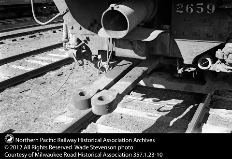

The "Business End" of a modern Northern Pacific Ry. Tender
circa early 1950s. In this case NP 2659 a A-2 class 4-8-4.
-Hudson
Correction: It appears this is the locomotive end.

Thanks HudsonL and joe6167 for posting photos of engine-tender drawbar details. Do the double drawbars share the load, or does one take over if the other one breaks?

From my article:
"The Safety Bar is longer then the Drawbar and ordinarily does not take any of the pulling force that the Drawbar handles, unless the Drawbar breaks. The top bar is the drawbar, while the bottom bar is the safety bar"
I couldn't remember off the top of my head and had to look it up! Good thing I wrote these articles, it saves me having to remember all this stuff!
