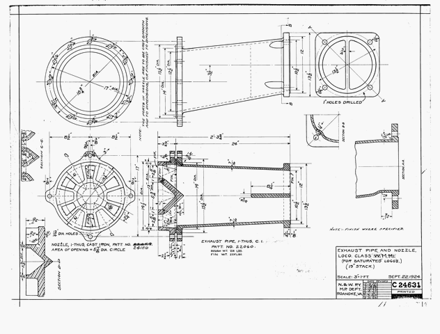

PostPosted: Mon Sep 02, 2013 10:33 am
Posts: 834
Location: Bowling Green, KY
Prints found on the N&W historical society page are obviously pay off a modernization program. Afterall, how many turn off the century locomotives were not modernized? (Lest they be on a shortline) What strikes me is the overlapping of revision dates, by a decade.
The attached drawing is for the stand and nozzle which accompany the new stack arrangement. As is shown in the drawing you posted [Kelly] there was a need to move everything forward to clear the delivery "T".
My guess would be (regarding redundant drawings) locomotives in more strenuous service received the improvements while they chose to not invest into motivepower that just loafs along a branch under light loads at a leisurely pace.
Thoughts?
Cheers, Jason
