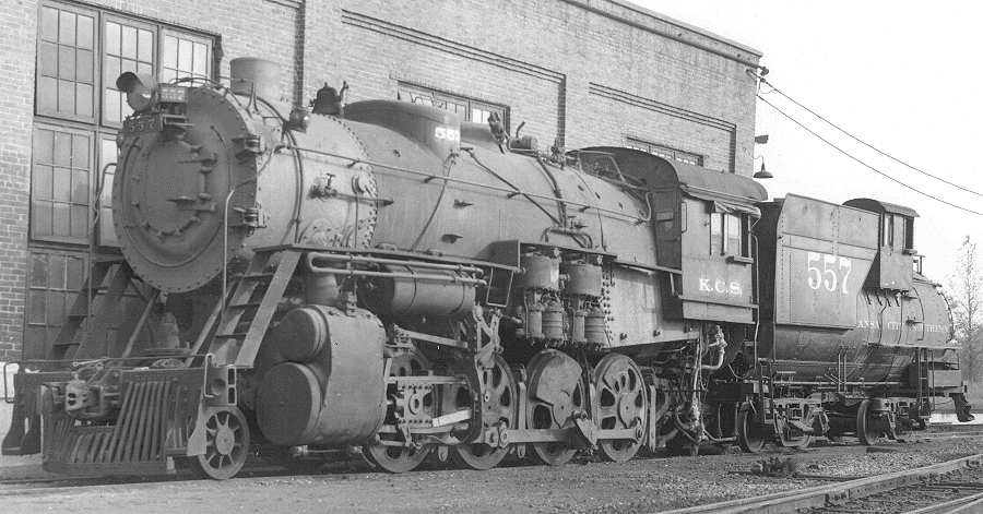

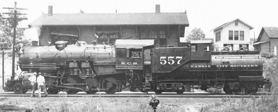

The following photos show 557 after conversion to oil.

And the little side rod extension is no longer on the engine! Thanks for the posting of the photos.

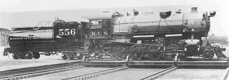

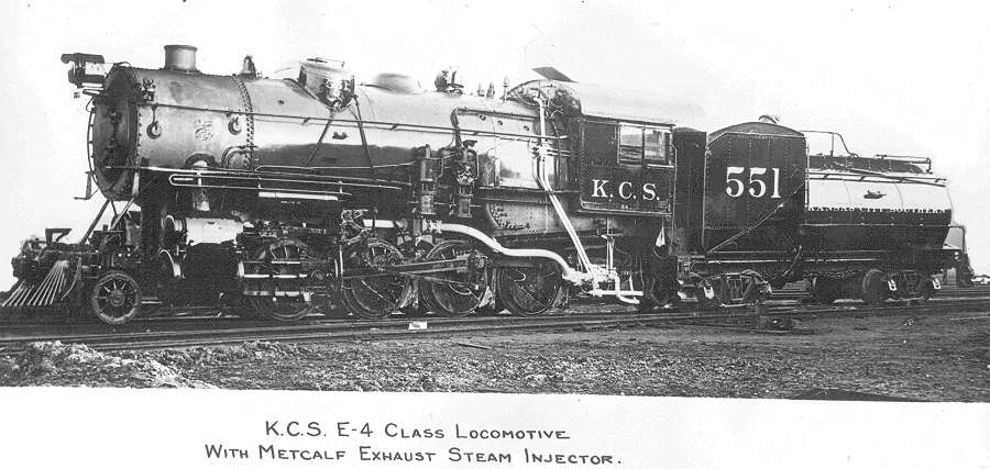

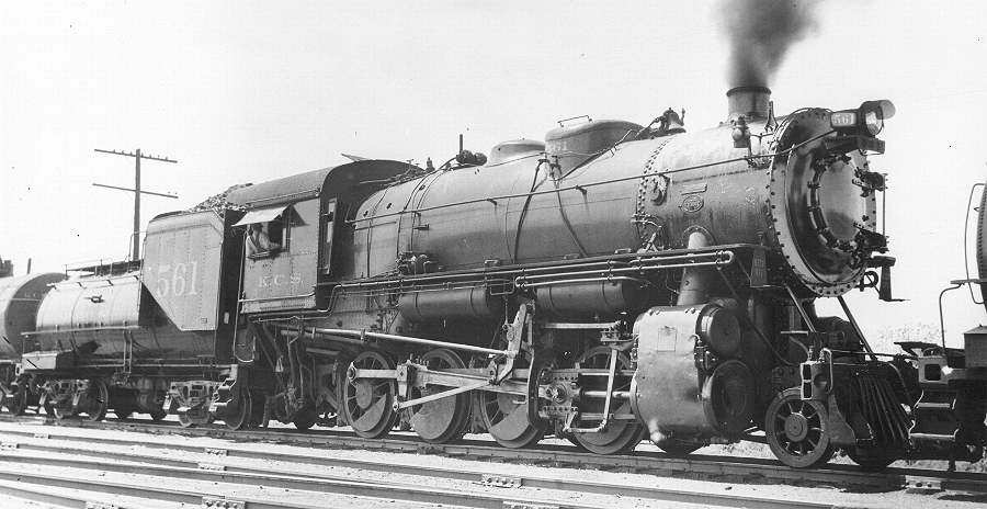

I've looked at photos of all the locomotives in the class. Here are a few of the oldest photos I can find of the E-4's. Unfortunately, none are builder's photographs like the one of 557.
File comment: Taken in 1925
File comment: Taken in 1926 on the transfer table at the Pittsburg, KS KCS Shops.
File comment: Taken in 1931.
