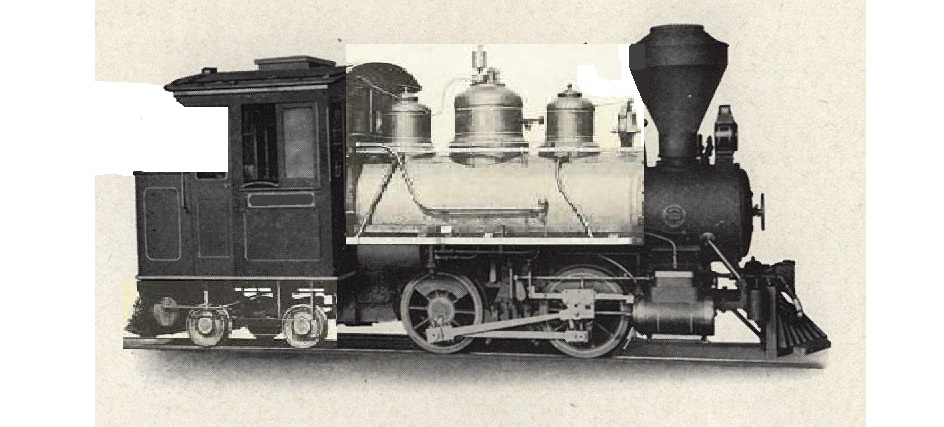

Looking over the details of this engine(those that are present anyway) I would with near certainty say this is a Baldwin product, and I would say the Quarry story is certainly plausible. Note the balloon stack hiding behind the engine in the original photo. Some of my reasoning for it being a Baldwin:
1. Dome Shape
2. Crosshead design
3. Cylinder design
4. Bell between stack and first dome
Reasoning to believe the Quarry Story:
1: Bent brackets
2: Stack broken off
3: Broken/Missing Sand domes
4: Appears Rear frame is bent
5: Obvious missing cab may or may not have to do with Quarry accident.
However, I believe this was originally built as an export locomotive(possibly narrow gauge). It has all the proportions of a Baldwin export model from the 1890's-1920. It may either be a late build, or a rebuild(to regauge) based on the crescent counterweights on the drivers. This also lends to the story that it is a quarry locomotive because many small operations bought either secondhand, or unpurchased orders that were meant for export. Finally here is a very rough composite of what I think the locomotive originally looked like. I'm on vacation so I used paint instead of photoshop.....

Looks like a balloon stack laying on the ground behind it.
Also looks like the remnants of the cab are turned 180 degrees and pushed up against the backhead.
Whatever it is, its a mess and surprised it has lasted.

Two things.... 1) it did not have a saddle tank, (as Dave pointed out) the dome bases fit the boiler radius and not that of a hypothetical tank 2) it was either an 0-4-2 0r 0-4-4 as is evident by the fact of there being an equalizer between the two driving axles. An 0-4-0 would have the rear springs going to dead blocks and the front would have dead blocks at rear and be cross equilized at front.
Either way, what a doozy of a boiler..... lap seam and no dome liner. The 30 in savannah had the same lack of liner issue which was rectified during the rebuild.
