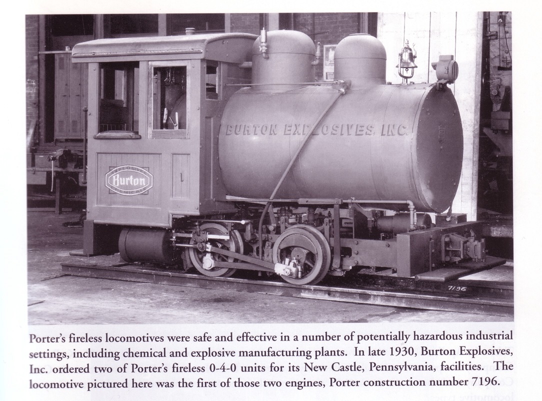

Under the front of the tank you can see the cylinder and the various slotted rods for the hand brake as I mentioned previously. As a side note, Burton #1 (shown in the picture) is now Apache #5 and running in Ohio. Burton #2 became Apache #6 and is back in Arizona for display after spending a few years running in NJ.
J.R.
