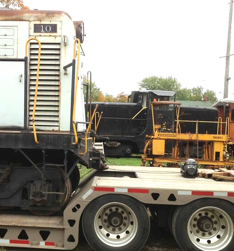

That was also the same truck that delivered D&M #10 from home rails to Project 1225/SRI... and from SRI to SMRS.
You may have noticed the tight fit in the above picture. See also:
File comment: half inch to spare!
Gamma is way up so you can see the clearance.
Seems like that truck is made for GE 44's. Its bed length is 29'2". The other end is a straight vertical, hence you must remove that end's pilot, coupler and pocket, and this end's pilot as you can see here.
(and by the way, when the unit arrived, SMRS crews refitted both couplers, pocket and pilots with an ease and efficiency equal to WRM's crews, except with fewer tools and outdoor conditions! It helped that member Chuck Fannin was a rigger by profession, normally accustomed to extricating derailed hot metal bottles from under oxygen lines.)
The same truck may have also moved the GE 44 in the background, WM #75 which awaits stenciling.
Generally one does not want to move a GE 44 by rail (except on flatcar) because the units have delicate "high speed" motors with a double gear reduction yielding a 35 mph max speed.
