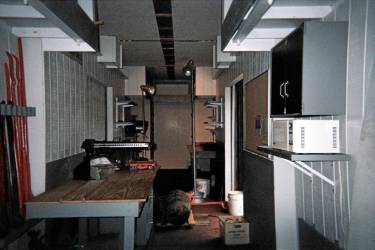

Photograph 1 – The camera looks from end to end inside the workshop built during the 14-year residence at Cressona, Pennsylvania. Interior walls and ceiling are framed, insulated, and covered with T-11 paneling and strand board to create a comfortable work area for year-round restoration activities. Large sliding pocket doors sealed-off wintry blasts while overhead storage lockers, corner equipment cabinets, and adjustable shelving provided ample storage for equipment and supplies.

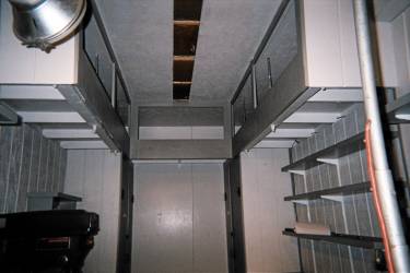

Photograph 2 – Large shop tools are securely fastened to floors and walls to prevent damage during occasional railroad switching activities. In addition, all shelving is constructed with raised lips to prevent items from rolling off. In this view, the camera pans toward the A-end of the car, looking across the radial arm saw and built-in snack area. The interior of the car is finished in an attractive two-tone grey paint scheme with tile red floor.

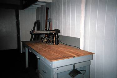

Photograph 3 – The radial arm saw was a workhorse throughout the project and will be sorely missed. Powered by a single phase, 230-volt electric motor, the 12-inch Craftsman saw could rotate about its column to cut right- and left-hand miters. In addition, the blade could rotate incrementally 90-degrees to either side and pitch 45-degrees off vertical. The homemade bench facilitated work on 4’x8’ stock and provided drawers for storage of additional hand tools and supplies. A built-in vacuum system aided clean-up activities. The 2”x6” and 4”x4” framing made it a solid piece of equipment.
That's a closed pocket door on the right...

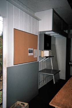

Photograph 4 – The car is equipped with a bulletin board and small lunch area. The folding table and microwave provide a few lunchtime creature comforts. The small grey cabinet held tea, hot chocolate, paper plates, napkins, and related sundries. When operational, folding chairs provided seating for four. A photograph depicting the original Rock Island paint scheme and an emergency call list are all that remain on the bulletin board. Safety was always a priority in the shop and emergency telephone numbers were kept in plain sight for immediate use.

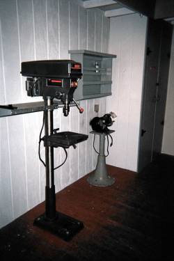

Photograph 4 – A drill press and bench grinder were also donated with the car - these tools sit oppose the work bench as shown in Photograph 1. In addition to the power tools, a small assortment of track tools were donated with the car, including: track jacks, spike mauls, a spot board, spike pullers, rail and tie tongs, and pinch bars.
I made a small table that secured the top of drill press - you can see the small metal bar holding the press in place as well as the floor bolts -- it was pretty solid. Again, the idea was to keep things decent when the car got switched around. The small shelves in the background held oils, drill sets, attachments, and the like.

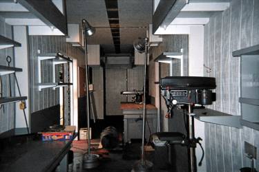

Okay, last one.
We built a U-shaped, over head storage space at both ends of the car - think they provided 57 cubic feet each if I recall.
Walls are framed with 2x4 studs attached to the floor and bolted to the DF racks. Framing for the storage lockers rest on top of the 8-foot stud wall. Walls are insulated with R-13 and covered with T-11.
Wall framing was extended to the a point near the roof to support 2x6 rafters running from side to side. The overhead storage is also support from the ceiling by 3/4-inch all thread. It safely held 100s of pounds of equipment for years w/o any problem.
We also built three, 2'x4'x8' storage carbinets in each of the three corners of the car. Each cabinet has 3/4-inch plywood doors and shelving as well as 2x4 support framing. In the fourth corner, we built a small changing room.
Pocket doors are 4x8 panels separated by a sheet of 1" foam - two doors per side. They are mounted on barn-style door tracks. Pockets are 2x4 framing with OSB and T-11 panelling. Above each door, I built a fan box to help clear welding fumes, etc.
In the coldest winter, we were comfortable without coats. We heated the car with a small kerosene heater. Gaps in the door and floor provided fresh air. Never had problems with CO
Anyways, hope I caught my typos - thanks for opportunity to share.
J Kovach
