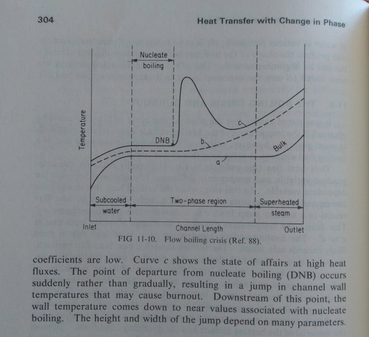

PostPosted: Thu Sep 29, 2022 5:56 am
Posts: 488
Two hundered years after 1756 when Leidenfrost described his "phenomenon", it has been studied and quantified and in a sense made generic as it is described now as Departure from Nucleate Boiling (DNB) heat flux (i.e. heat transfer rate). How much heat can you shove through a surface with water on one side and the boiling changes from nucleate boiling (small bubble) to film boiling. It is one of the most critical values derived in my "How to Design a Nuclear Reactor in 13 Easy Chapters" college textbook. It determines how much heat you can remove from a reactor core without causing a meltdown. Which is pretty much the same as running a dry crownsheet.
I have been in all of the boilers of every steam locomotive in Hawaii over the last 40 years and was good friends (from when I was 13 yo) with Jay Conde, author of all the Sugar Train books and noted historian. Over 250 steam locos were in Hawaii and in all of history not one explosion was recorded. Not that they did not get low watered or mud burned, but no booms. I am not as familiar with Rocky Mountain narrow gauge, but no big booms come to mind.
I have read an article from the 1880s, about a PRR test in the late 1860s, to test the water on a hot crownsheet boom theory. The author could not locate the documented results from PRR but had access to the industry journals describing the test. They took a serviceable boiler, put it in a field, built bunkers to witness the results and tried to blow the boiler up. They couldn't do it. Four or five attempts and just got leaks. Fixed the leaks, fired it again, low watered it, raised the water, ad infinitum......
The difference between a crownsheet failure (Gettysburg) and an explosion depends on the rate of pressure release above the waterline.
Mechanics of an Explosion
About 20 years ago, I did some calcs and basically determined that flashing water to steam on a hot crownsheet would only trigger an explosion if the crownsheet was about 15 seconds from launching anyway.
Here are the scratch pad calcs:
Assume a K-36 with 4' x 4' of the crown red hot. Thickness is 3/8"
Under high fire, the sheet will be about 700F, take away the water, the temp climbs to orange color about 1200F. A 500F difference. total BTU increase 13,700.
How much water will that boil? About 17.6 lbs of water or about 2 gallons. How big of a pressure spike while all of this occurring at 200 psi in a boiler generating about 20,000 lbs of steam per hour?
The real kicker that quenches the "cause a boom" theory is that the steam production rate is SEVERELY REDUCED because the steam generation is occurring above the Leidenfrost/DNB point.
So, to water a dry crownsheet or not? How close are you to the 15 to 30 second window of inevitability anyway? To quote my favorite Dirty Harry line, "Do you feel lucky???"
