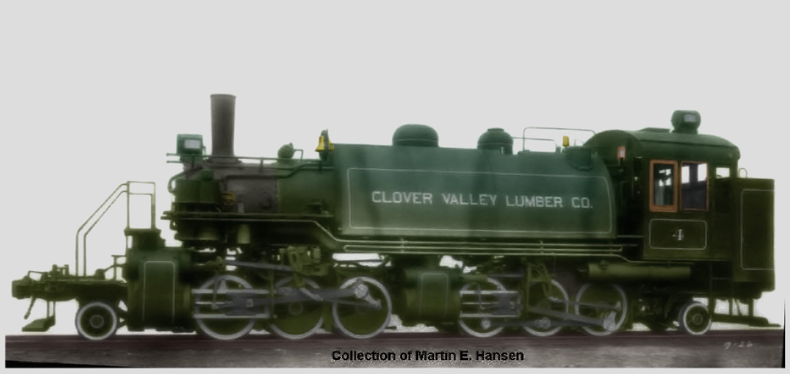

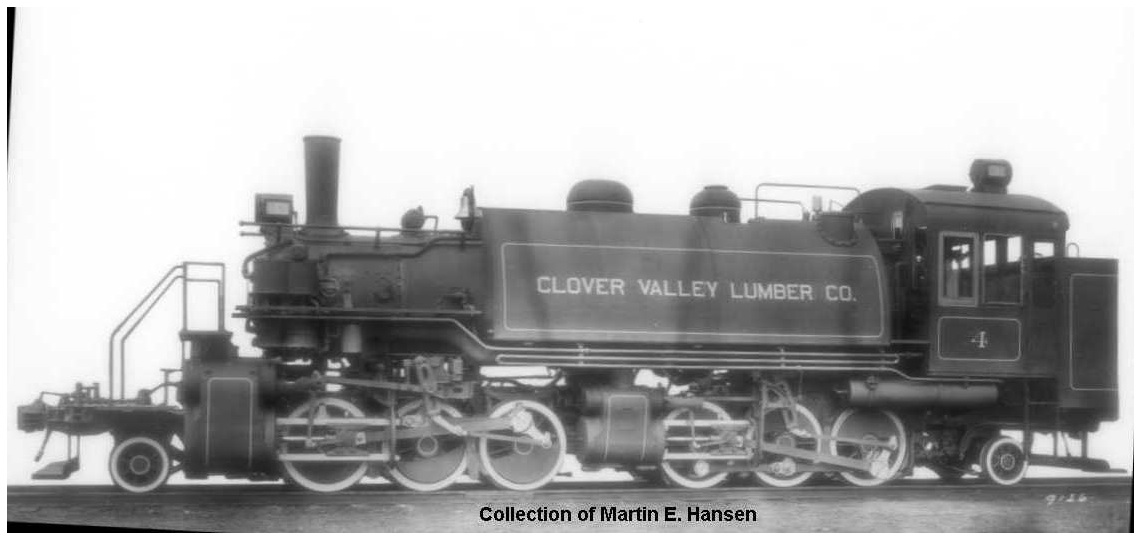

Looking forward to seeing it (or at least photos) in green. The Pacific Locomotive Association's Clover Valley #4 (2-6-6-2t) was delivered in green with aluminum stripes, but is currently being painted into a later, black appearance.
Black and white photography can be deceiving. I believe a lot of dark-grey looking builder's photos were of engines that were painted green. Some have claimed that builder's intentionally painted locomotives in a flat grey color for builder's photos, but I find it hard to believe the expense and effort would be justified. Can anyone substantiate this claim with evidence?

While it does sound unlikely that the locomotive builders would go through expense of painting one side a locomotive grey just for the sake of a photograph, that is indeed what they did.
This effort was expended due to the need that the official builders portrait be not just a pretty picture souvenir but comprise an official record of the company product. As such it was also used in advertising and it had to look as prefect as possible.
In some ways, photography as not changed much at all. It is all about light, exposure and contrast. So in order to show off the details of the locomotive, one side was painted grey to reduce contrast so that all details of construction could be seen. Since this was to be the finest image possible, striping and lettering was also applied. Shiny black paint in high sun would be worthless since so much of the loco would be in shadow and the highlights distracting to the eye.
ALCo and Lima shot the engineer side, Baldwin the fireman's side generally.
The photographer would also want and probably waited for a cloudy day to reduce contrast as much a possible. Grey boards would be set up behind the loco to that the wheels would silhouette. This would also aid in the inking of the negative so that all background detail could be removed if that was the style like at Lima. Obviously after the photograph was approved, the paint crew then repainted the loco.

I remain skeptical. This is exactly the explanation I've heard before, but it is presented without evidence. You may very well be correct, but I needing something that goes beyond hearsay or even secondary sources.
I know enough about photography to know that you could achieve all of the desired effects through lighting and exposure. It is not hard to make something black look grey if it's against a background that has been painted out on the negative, and if you can do that, why pay a crew to paint an engine twice, especially in a one-off order? I continue to believe that grey-looking engines were either the result of technique or green paint. I do believe they painted the tires with wider stripes for the photos, but that is a lot less work.
I could be wrong. I am willing to admit that, but just because something is commonly believed to be true doesn't make it so. I have seen speculation turn into a truthy "fact" too often.
CV 4, Collection of Martin Hansen
File comment: B&W Builder's Photo
So here is a builder's photo from March 1924. The engine looks flat grey, but is it? The records show it was delivered in Green with Aluminum striping. What are those strange diagonal stripes on the tank? Could they be reflections in glossy paint?
Colorized
File comment: Colorized
