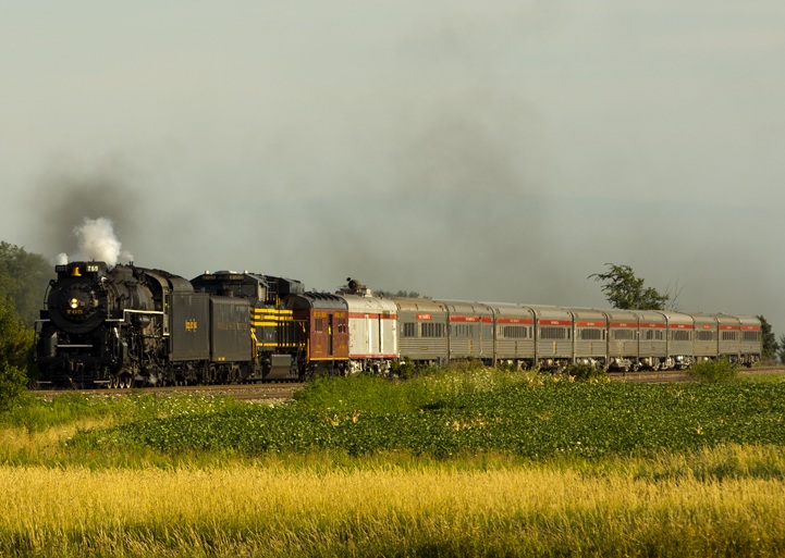

I'm just going to leave this setting here.......
402 seats
Functional A/C
HEP equipped w/ Power Car
Tightlock couplers
All AP bearing equipped (EE or F)
All cars D-22 or 26-C equipped
402 seats
Functional A/C
Tightlock couplers
OK, I'll bite with the $640,000 question:
How much to run them to, oh, I dunno, Washington DC, Chicago, Atlanta, etc. for two weekends' worth of trips, provided we find a host railroad willing?
