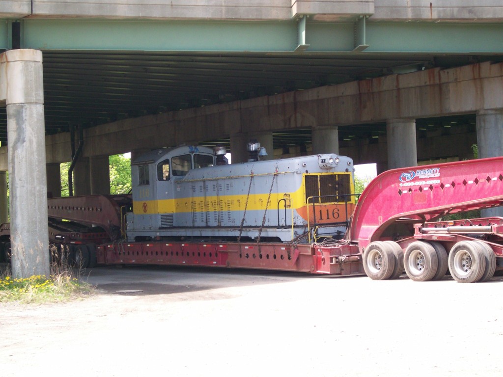

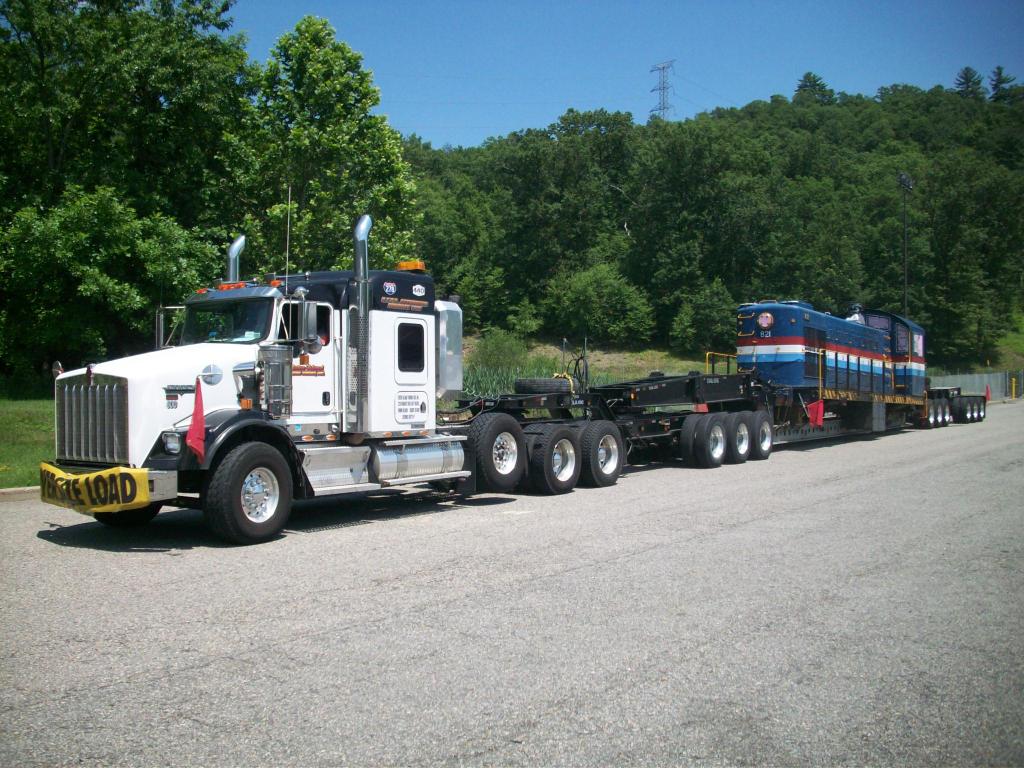

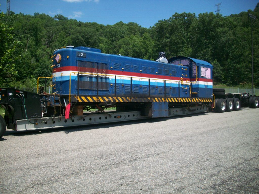

With locomotives, removing the trucks takes away a lot of the weight issues, but doesn't save a lot of height. Height becomes a major issue. For an ALCO switcher, the steps can be removed, and it becomes straighforward to use a beam trailer if the reservoirs are removed. This one fit neatly between the battery boxes. However, height was still a major issue and to get the height down on the cab end, the coupler pocket had to be removed (not an easy task). For an EMD switcher, the steps and fuel tank cannot be removed, making it much harder to get the height down and requires a much more serious trailer.
BBH
