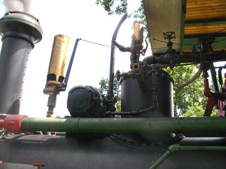

I hope he is also marketing to the steam tractor people as there are lot more of them than there are locomotives. How many need or wish to purchase new dynamos is another matter but the market might exist. I think they tended to be a different voltage. If the volume doesn't justify specific models some might still purchase a 32V model and replace their bulbs. (Or sneak in an electronic regulator.)
Steve

The traction angle is a good idea!!! A locomotive dynamo can easily produce 24v as well, in the 24-32v range voltage is achieved by adjusting RPM.
