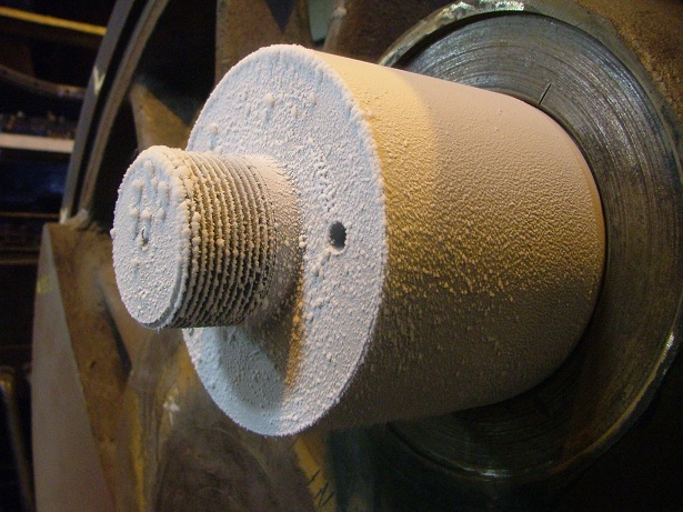

Brrrrrrr...

Posts: 135
Goodness...
Can we say new crank pins anyone? Cold enough to chill a beer on!
Hard to contain the excitement...Grand Canyon used to brag about having the most modern Mikado since the "restoration" age began...I think they are getting ready to lose that line.
