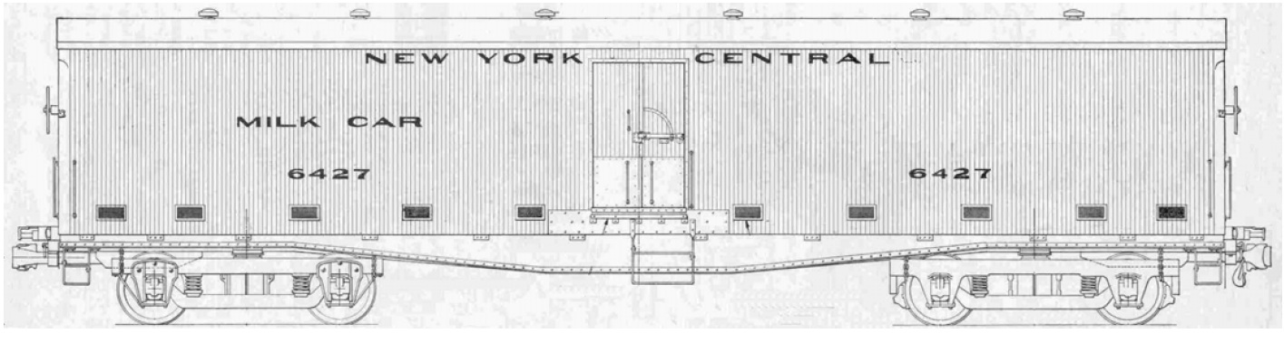

I wonder if drawings exist for this type of milk car? It's really a neat piece of railroading equipment.
Best I could come up with Richard.
Drawing by John Giesel,maybe from July 1953 Model Railroder.
Car was built by Merchants Despatch to NYC design. Rutland also had cars built to this design. LOA over buffers is 53'8", inside length is 49' 2"

Wow! Thanks for the research! She's a "looker", and would make a nice addition to any model railroad. Be fun to scratch build. At the moment, I am building two L&NE bobbers in 1/8th scale, and trying to finish my Long Island C420. A milk car would be great to run in a passenger train consist.
