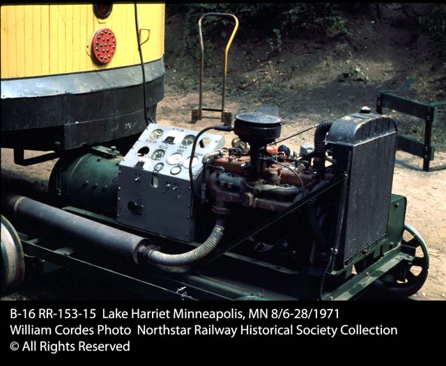

The original Como-Harriet streetcar "Goat", Dodge flathead 4 cylinder, trolley bus motor.
This is the original configuration, it later acquired a headlight & a homemade from copper tubing oil cooler.
It kept it's original engine as long as it was in MTMs possession, last I heard it was on it's 3rd or 4th trolley museum and one of them may have converted it to diesel.
Mr. Isaacs was a engineer for Onan, so it was well designed and reliable, other than overheat problems on really hot days, so on hot days we sprayed down the radiator with water during station stops to keep it cool.
-Hudson

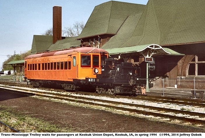

The original Keokuk Junction Railway hosted a generator-powered trolley operation called the "Trans-Mississippi Trolley" in the early 1990s. It ran from the Keokuk Union Depot (http://www.keokukuniondepot.org) across the Mississippi on the city-owned swing bridge to Hamilton, Illinois, and then up almost to Elvaston and back. It was also pressed into service during the 1993 flood, to operate across the Keokuk Dam when the highway bridge was out of service (our son rode it to get to work across the river).
