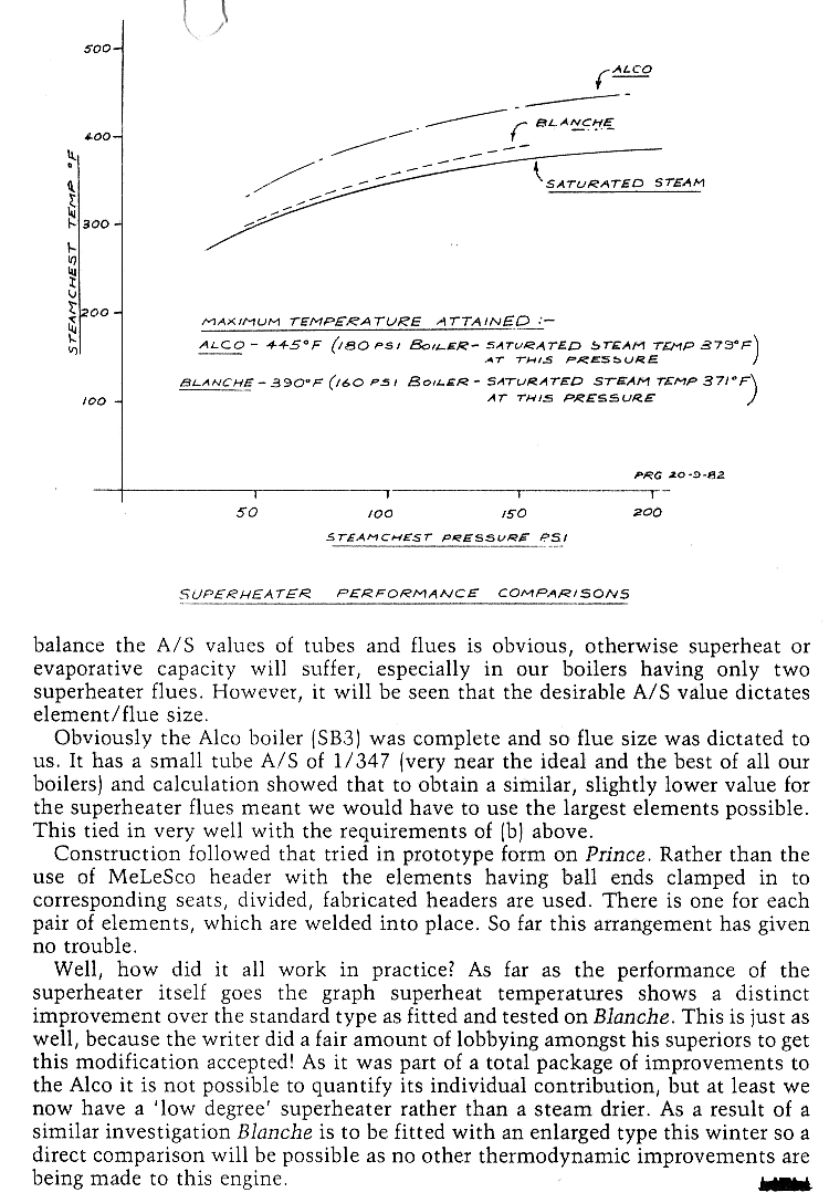

Page2
Less words, more hardware. Only what others say can not be done is worth doing.
