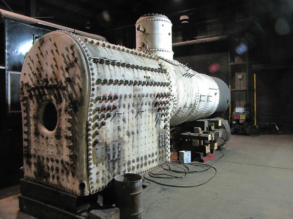

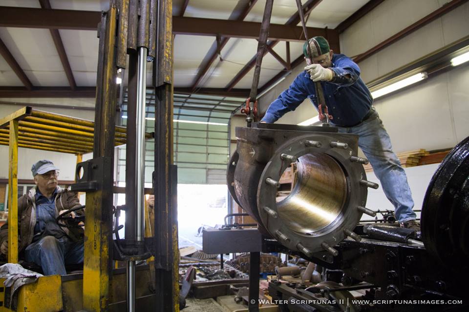

Generally:
1) The boiler has been finished and is in the main Cass shop, and ready to be installed.
2) The tender tank is ready to be installed on the tender frame.
3) The boiler saddle has been attached to the loco frame in preparation to mount the boiler.
4) An attempt to mount the left cylinder failed due to some misaligned studs. It was discovered that the original construction had misaligned studs, so the properly aligned studs have to be misaligned/bent. Clear as mud?
5) The engine and tender frame/trucks assembly is ready to be moved to the main Cass shop for tender tank placement, and probably boiler placement at the same time? (Right Grady?)
6) Grady will not forget his RYPN password again, ever.
