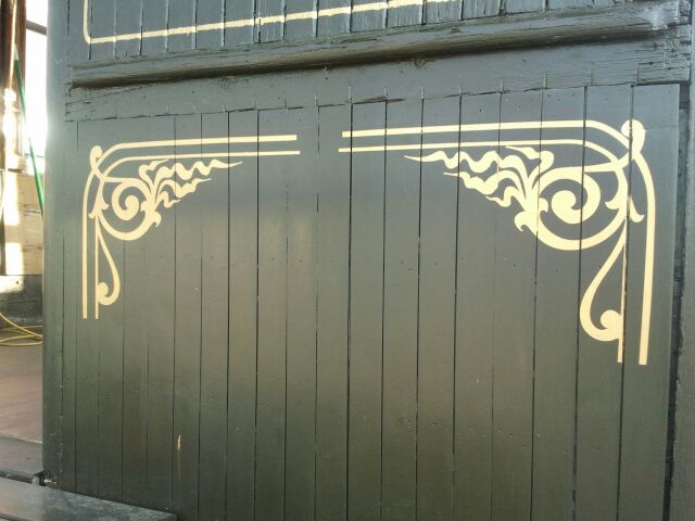

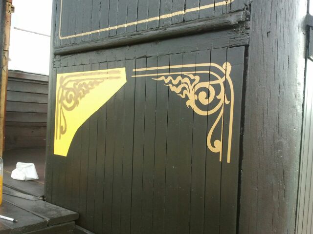

Just tried my vinyl masks i had made from my original drawings taken from a 1890 Pullman works photograph. Very impressed with the clean lines and ease of application on a wood surface.
Mike Pannell
