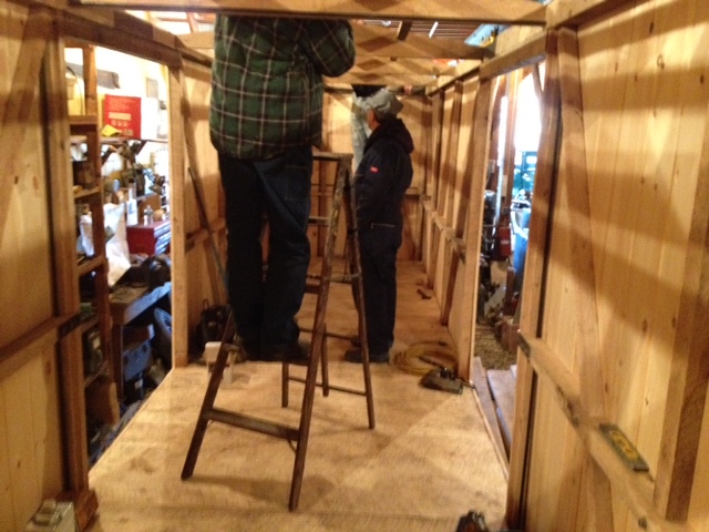

The oak went from logs to lumber being used for the car in less than 2 weeks. The pine went from log form to being cut to length and shipped lapped for the floor in about the same amount of time. I attached one slightly fuzzy cell phone picture of the north end of the interior of the car. The floor is still open so the chain fall can be used to put the coupler in.

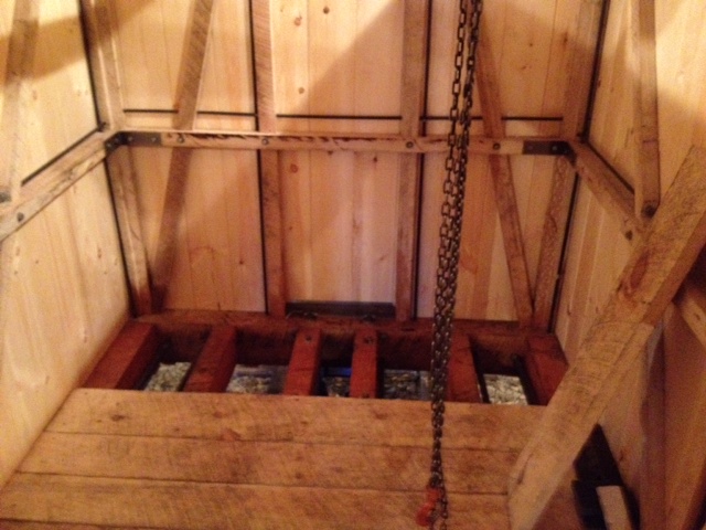

This picture looks towards the south end of the car. This picture and the one above were taken during the winter work weekend at the end of Febuary.

As to drying the wood ... with the pine flooring it doesn't matter that much as the lumber laps under the interior sheathing so if it end shrinks a bit, no problem. The interior (ship lap) sheathing, the exterior edge and center bead sheathing and roofing was dried prior to use. The oak was cut into sills, studs corner posts, sway braces and belt rails which sat for a little while before construction began. The studs, belt rails and corner posts are better used when fresh as the oak gets hard to nail into and pre-drilling for all the exterior and interior sheathing would be almost impossible. The oak parts are held true with (sistered) steel tension rods as well as the sheathing. There is a tension rod with every stud, rafter and corner post. There are cross rods holding the ends and first sway braces true. There is a lot of steel in a wooden freight car body.
