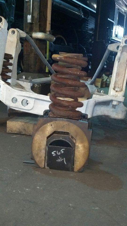

Here is the journal box, brass, grease box, spring and pins. It's been a long time coming!

Back to the image Steve posted above, pardon my ignorance, but what is the part in the center of the assembly, labeled 565 #1? To my untrained eye, it appears as if it normally wouldn't be there?

It is the partially completed oil cellar, they will cut out a half circle for the axle to finish it. The journal brass is dropped down some from the box, imagine the full circle from the brass thru the cellar.

We have to size the brass up to the axle next then we will do the final cut of the grease wells.
