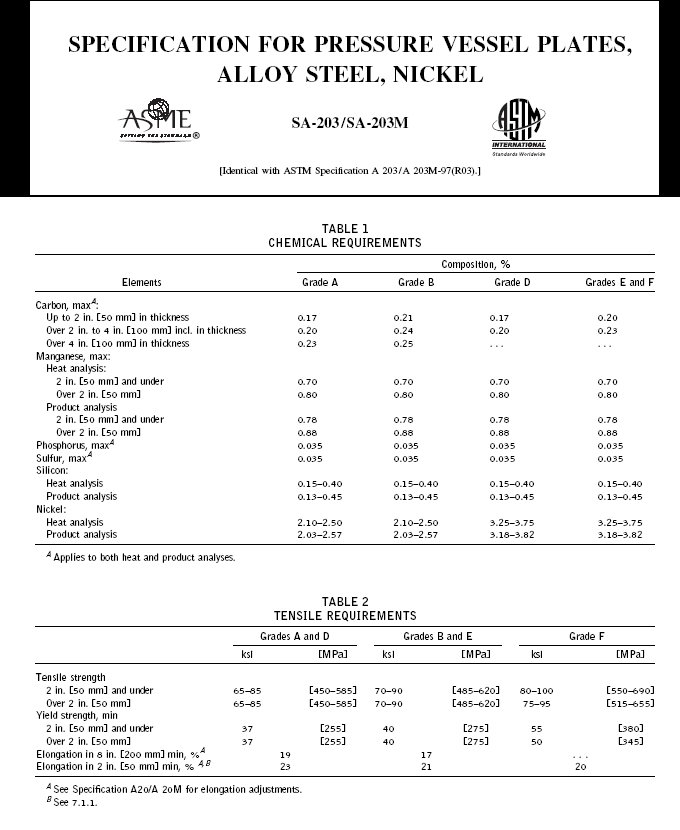

Txhighballer wrote:
The nickel steel problem ...
Does anybody know what the alloy of this firebox plate was? Specifically, is there a current or former ASTM or ASME material designation for the plate?
It sounds to me like the plate that developed cracks around the rivet holes may have been a low chrome alloy, something akin to SA-387-11 or SA-387-22, commonly referred to as 1-1/4 and 2-1/4 chrome. The chrome alloys have a silly habit of developing cracks months after going into service if the heat before, during and after welding is not carefully controlled.
Thoughts?

It was S-43 in 1940 converted to
SA-203 GR. A by 1949 and was in 1992 Section I. Weld P-Number is P9A.
Is not allowed as a Section I material in 2010 Code.

Joined: Mon Mar 14, 2011 6:45 pm
Posts: 89
Thanks Matt, I appreciate the information.
