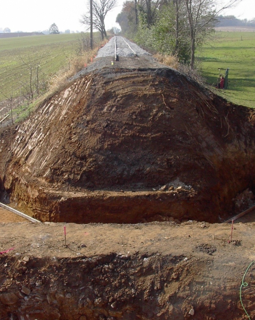

Well wonder no more ... We've been a little busy with this project to reply. Here's a shot of the western approach and abutment location. One can see the new ballast lifts needed to raise the rail profile.

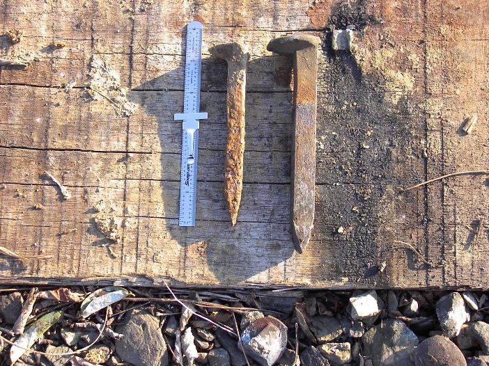

Steve, did you guys find any good artifacts during the dig?

Funny you should ask - the 0.625 spike is contemporary. The other spike came out of the east abutment fill. While probably not from the @1850's laydown, it may come from the rail that was in place prior to receiving the 1910 PRR realignment rail. (Around 1910, PRR realigned its mainline. SRC inherited some of the mainline rail, 85 lbs stuff, the last of which is still on the Leaman Place curve. You could tell it by its size, wear and bond points.)

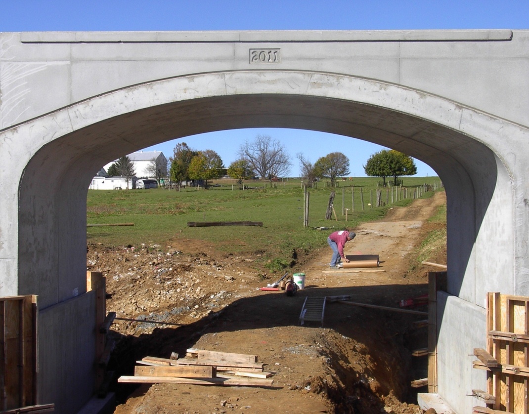

A shot of the south aspect this afternoon ...

Very Nice, was that precast or formed on site?

@Mike, precast.

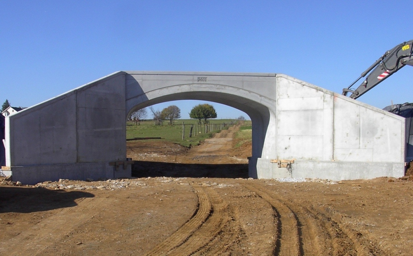

Erection was completed today. Tomorrow they tighten up the HDG gibplates and finish the backfill.

Very nice work; the ballasted deck will be a big improvement over the bridge timbers. It looks very DL&W or NYW&B-like-- and just 100 years after those marvels of concrete railroad construction were new.

Howard, you beat me to it; I got a Lackawanna impression, myself.

I was thinking the new bridge look like PRR or Reading , by the books I have looked at through the years.

@Howard and EDM, the DL&W is intentional.

It looks like a Con/Span, which are precast at the factory and very quickly dropped in place.
