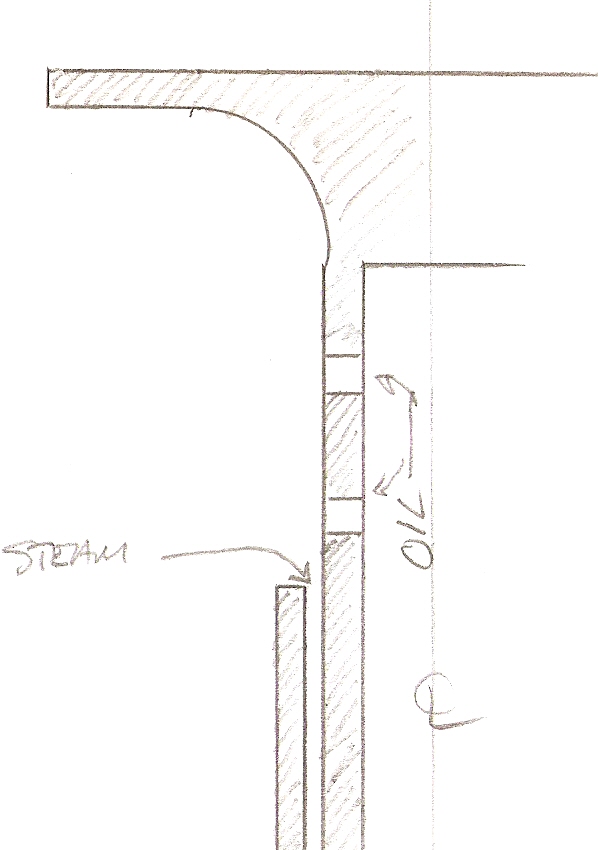

Basic conceptual sketch of the burner from the 2 foot 0-4-0T - I'm told the development of the curve and proportioning of the rest are critical, so please don't do this at home, experts over there already have it worked out.

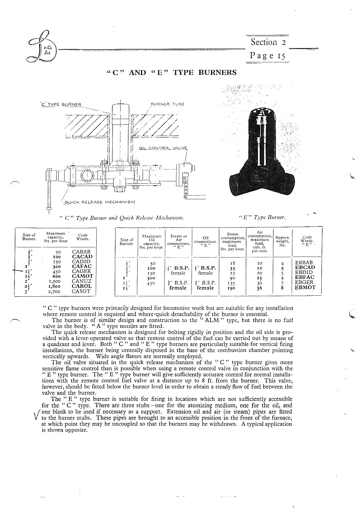

Gents, Nigel was kind enough to send me some images of a Laidlaw - Drew catalog that shows their burner technology, and here they are.
I'm struck with the cultural / expepriential links between the development of the LD into the Ffestiniog / WHR burner, and with my basing the circular burner sketches on the VB. We work from what we know........ and Yank and Brit practice are very different.
It seems the LD burners were interchanged for different weights of oil, so while they are more "technological" they are also more limited individually than the VB in terms of what fuels each can handle.
dave

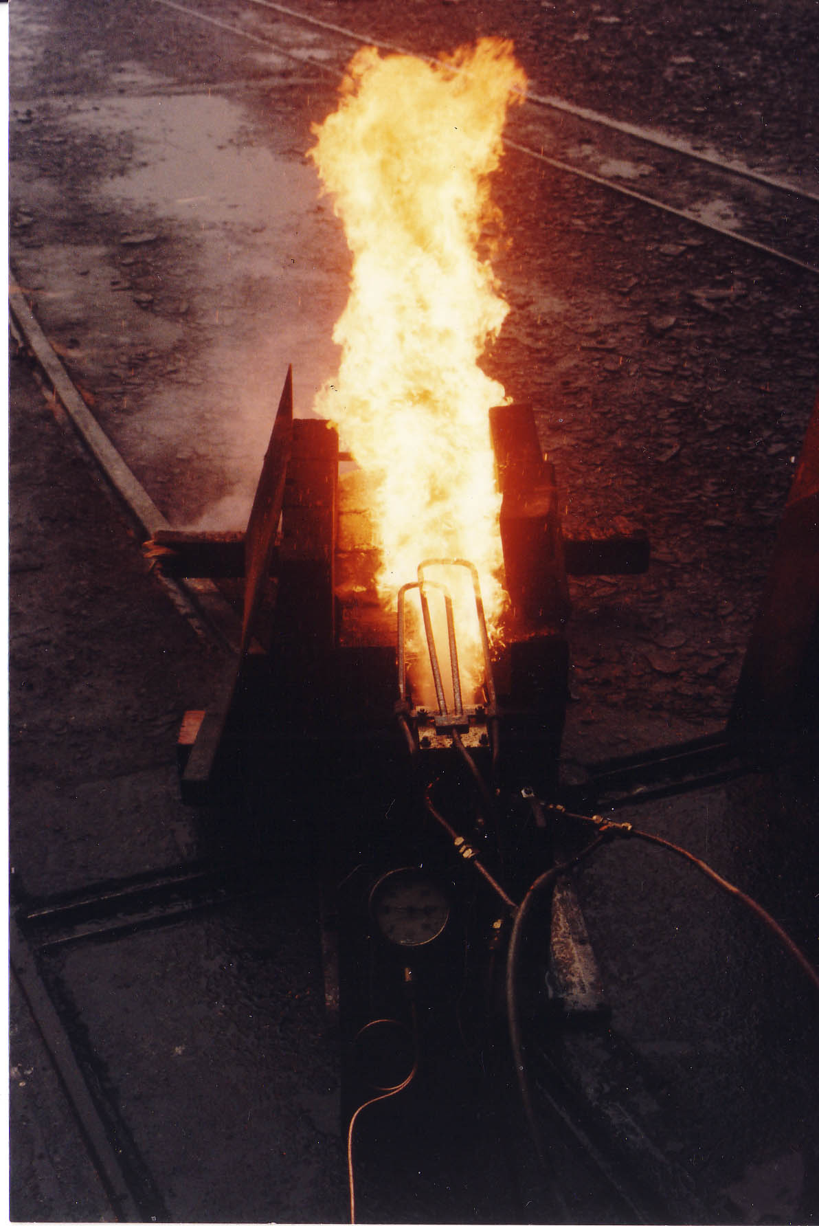

The first of the three pictures shows my test burner where I was establishing the priciples of impingement. These where taken from Lempor chimneys, Whistles and the Laidlaw burners. Its all done in a straight line, where as in the second picture you can see the spirial flutes for the steam of the L/D burner. The noticable feture on the flat burner is how the resistance to flow is greatest in the corners and also the flame starts nearer the burner. Incidentaly the flame length is proportional to the size or fuel consuption of the burner ie the more fuel the longer the flame. Its imperative that the flame length is less than the distance to the tube sheet. Idealy it should not extend beyond the fire bed like a coal burner which is why round burners ahve an advantage and better form to recreate a fire bed like coal.

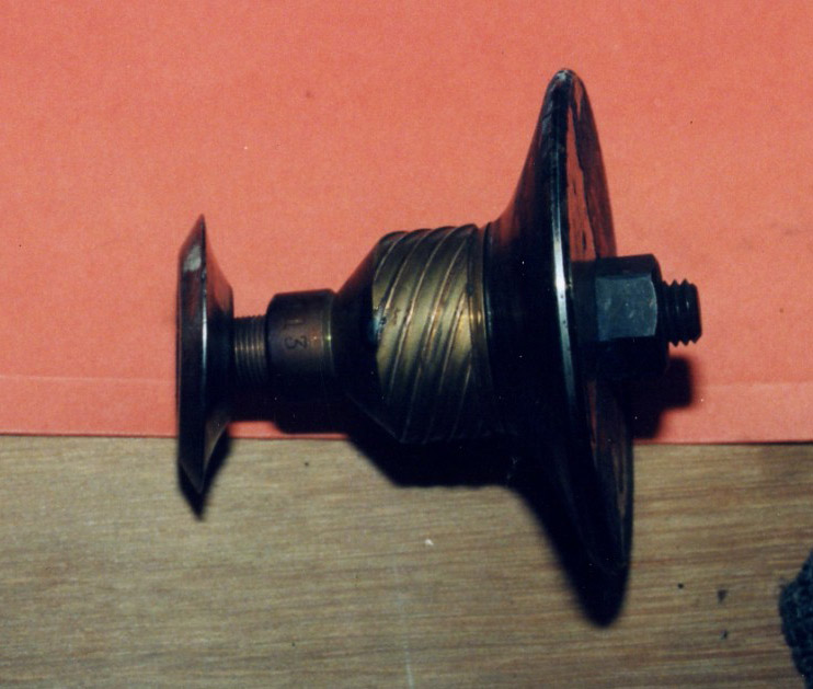

The second picture shows the swirl of the L/D burner and cap. The fuel gap is not set and is between the swirl and the cap. The size of gap being depndent upon the fuel burnt. The cap shown to the left is off a F/R burner and up side down where the one to the right is a L/D cap from SMR. The forms of both the swirls and the caps are many and dependent upon the designers whim. I have even seen types where there are no swirls just a guide but I find them very undesirable to set up. There is should be another picture of one with axil flutes but yet again they do not forfil the optimum form for impingement and suction on the fuel.

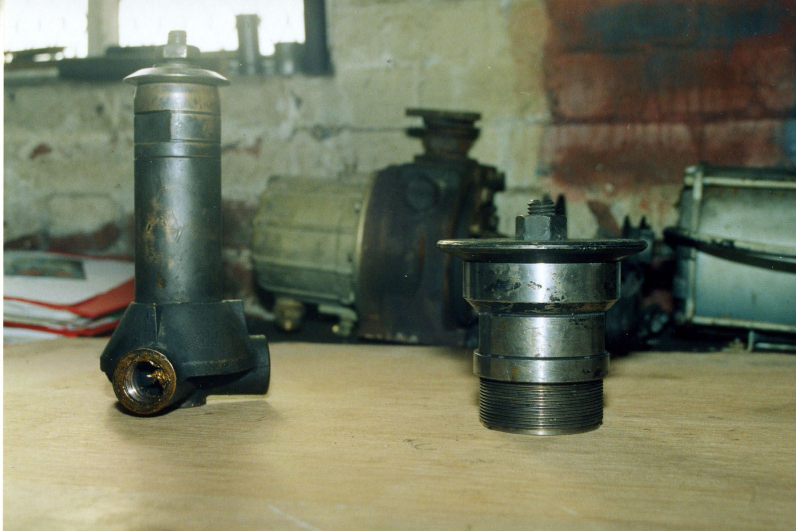

The third picture shows an assembled FR burner on the left and the top of a larger burner. Both are not set up so the exit gap for the atomised fuel is not there but you will see the difrence in the cap forms.

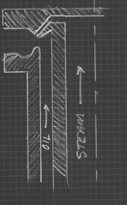

Sketch for an impinging central burner quarter cross section. This could be very messy.........or it could, assuming proportioned right by experimentation, provide a burining cloud of gassy oil.

Good, but not a grove but flat out to the dege

Modified LD with in-line meshing fuel gap not set
 Post subject: Re: central oil burner - Howard
PostPosted: Tue Nov 29, 2011 7:35 pm
I think the comparison is between the srraight steam grooves on this one and the swirling grooves in one of the photos a few postings above.
Groovy.......and both work. The straight grooves are much easier to make, however, not like hobbing a worm gear.

The spiral flue is more refined. The goved one gives less suction on the fuel.
