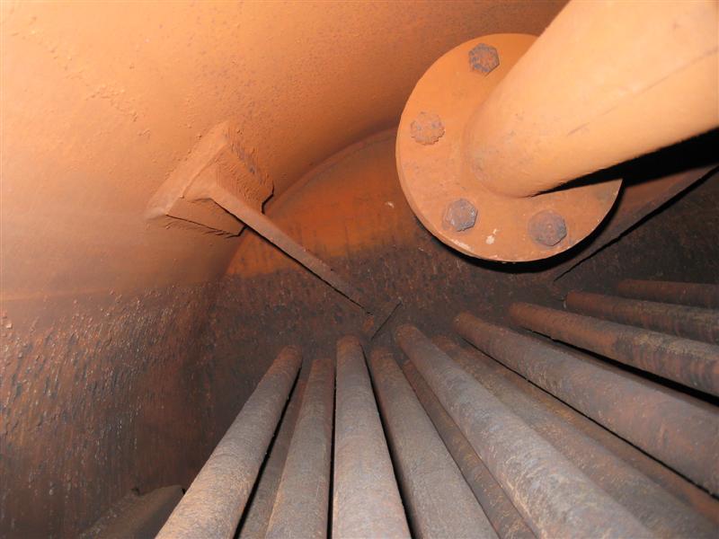

Nigel I will have to wait until thursday 21st to get the blower pipe dimensions.
Metric/Imperial doesn't matter to me,as I transitioned from imperial to metric when metrification was introduced into Australia, I use which ever measurement is the easiest to read at the time.Imperial measurements sure confuses the heck out of the younger generation though.
I should say we burn run of the mine coal because thats all we can get before it goes through the crusher. It has 20.5% ash content
Energy rate of 22-24 mj/kg,
Volatile Combustile matter 26-30%
Moisture 10-12%
Total Sulphur less than o.4%
And an Ash Flow Temperature of 1450degrees C.
I will try my best to upload photos.

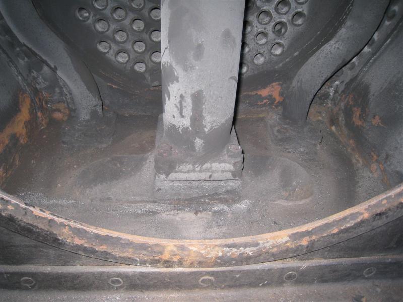

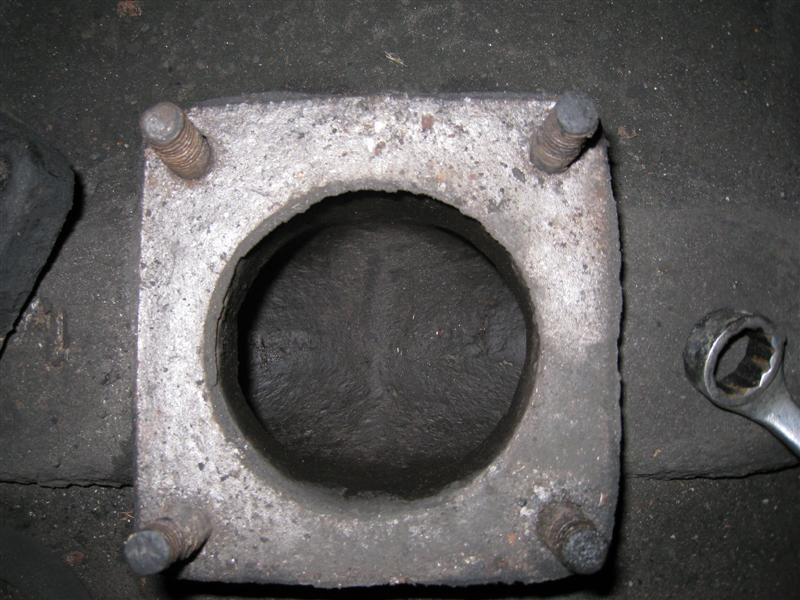

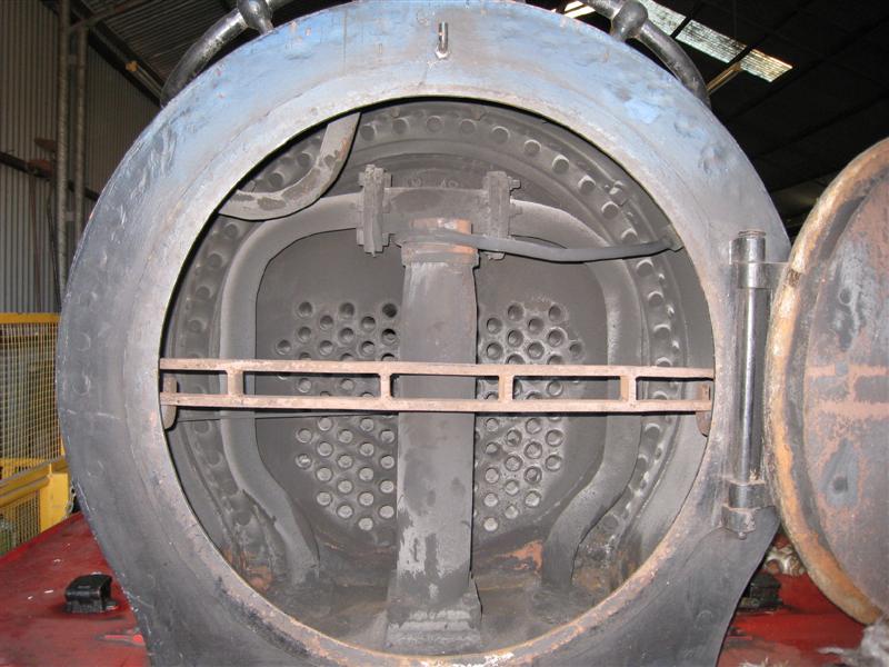

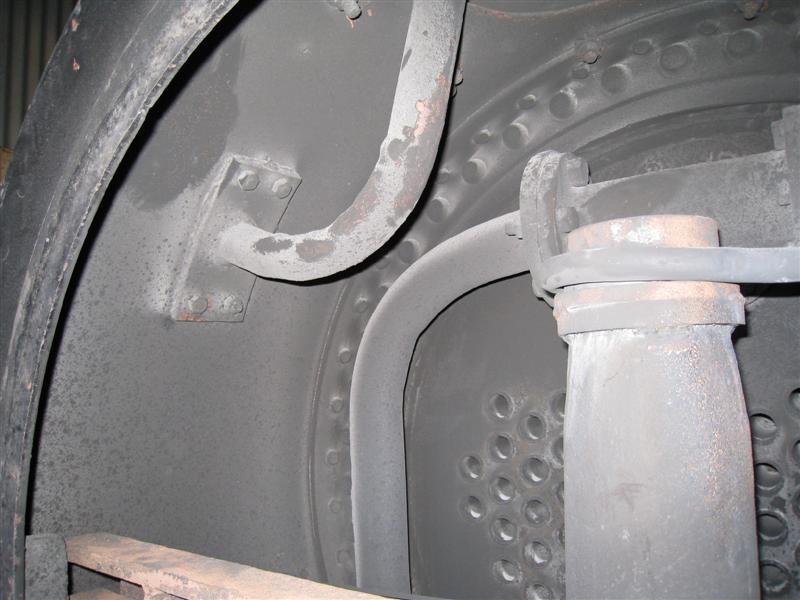

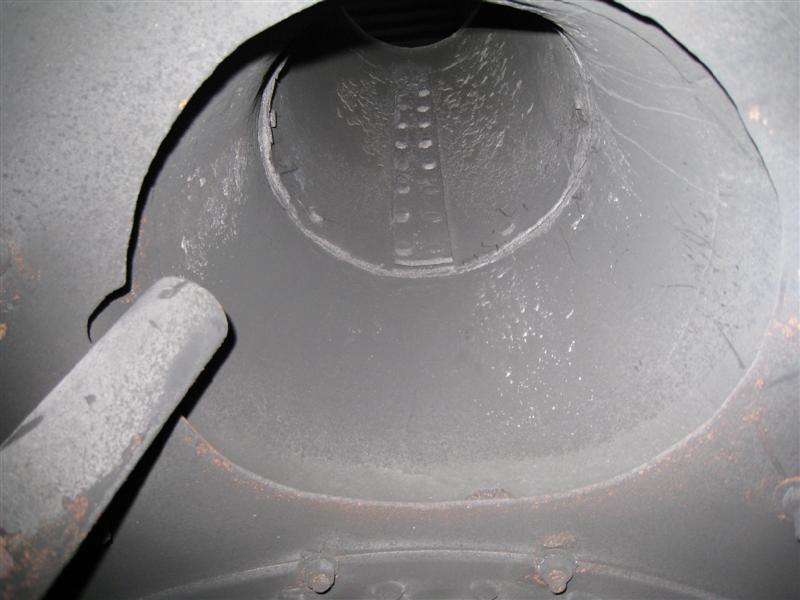

More photos.

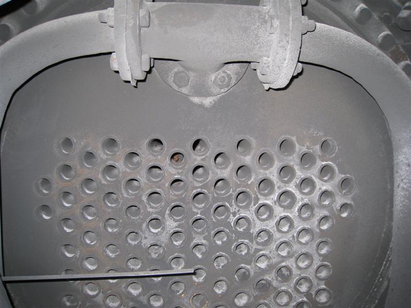

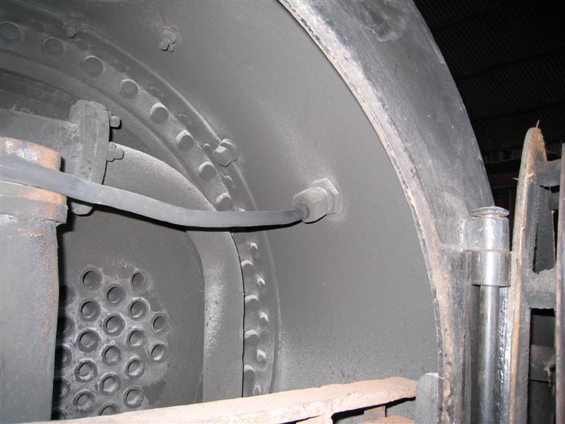

More photos.
Nigel, if there are any more photos you require tell me so that I can get them for you.

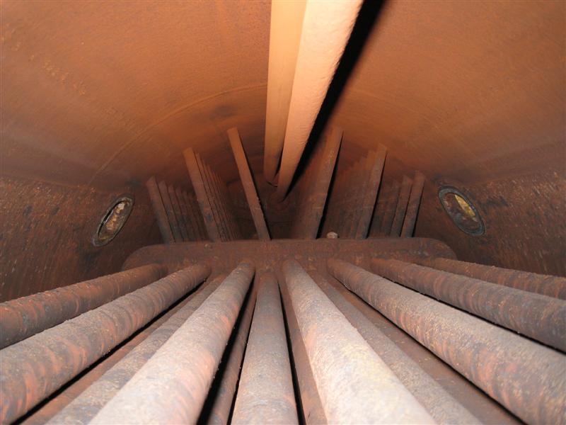

Top half tubeplate showing pipe for measuring smokebox vacuum.jpg [ 68.45 KiB | Viewed 8476 times ]

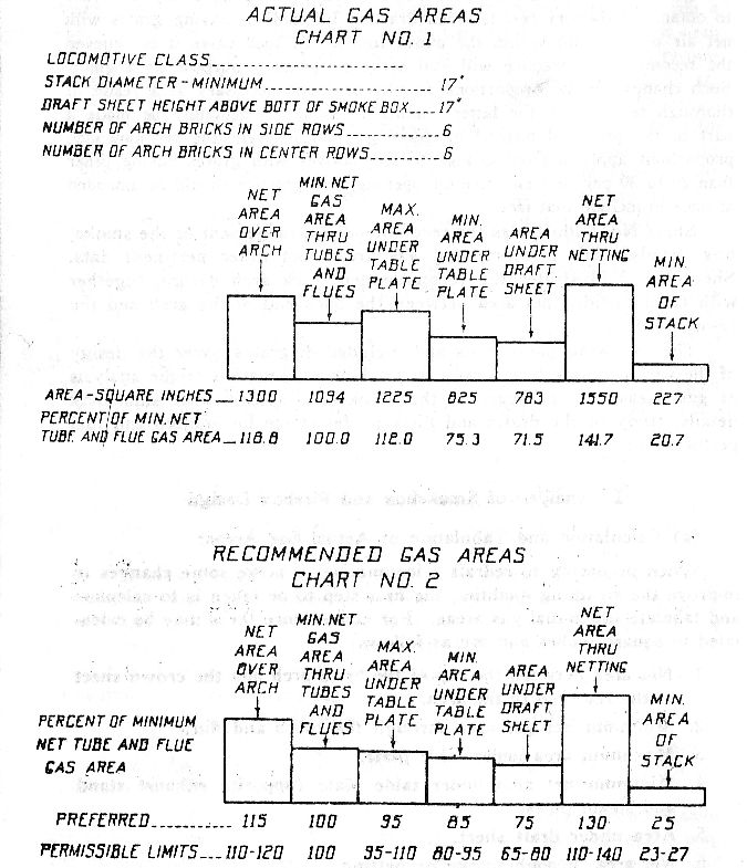

Here's a chart of gas areas that Nigel sent to me for posting. He mentioned to expect some associated drawings tomorrow, and I'll post those when I get them.
I assume gas area, in the context of tubes and flues, refers to the sum of the cross-sectional areas of all of the tubes and flue ID's?

The table of AAR recomended areas is also there now and yes it dose use the GFA of all the tubes in is proportions. Please remember that some of these proportions are for a difrent type of chimney and draughting so have to be modifed to suit. I am mearly pointing out the principe of the required proportions of gasflow.

Here are the two charts Nigel passed on to me to post. Thanks for the education, Nigel!

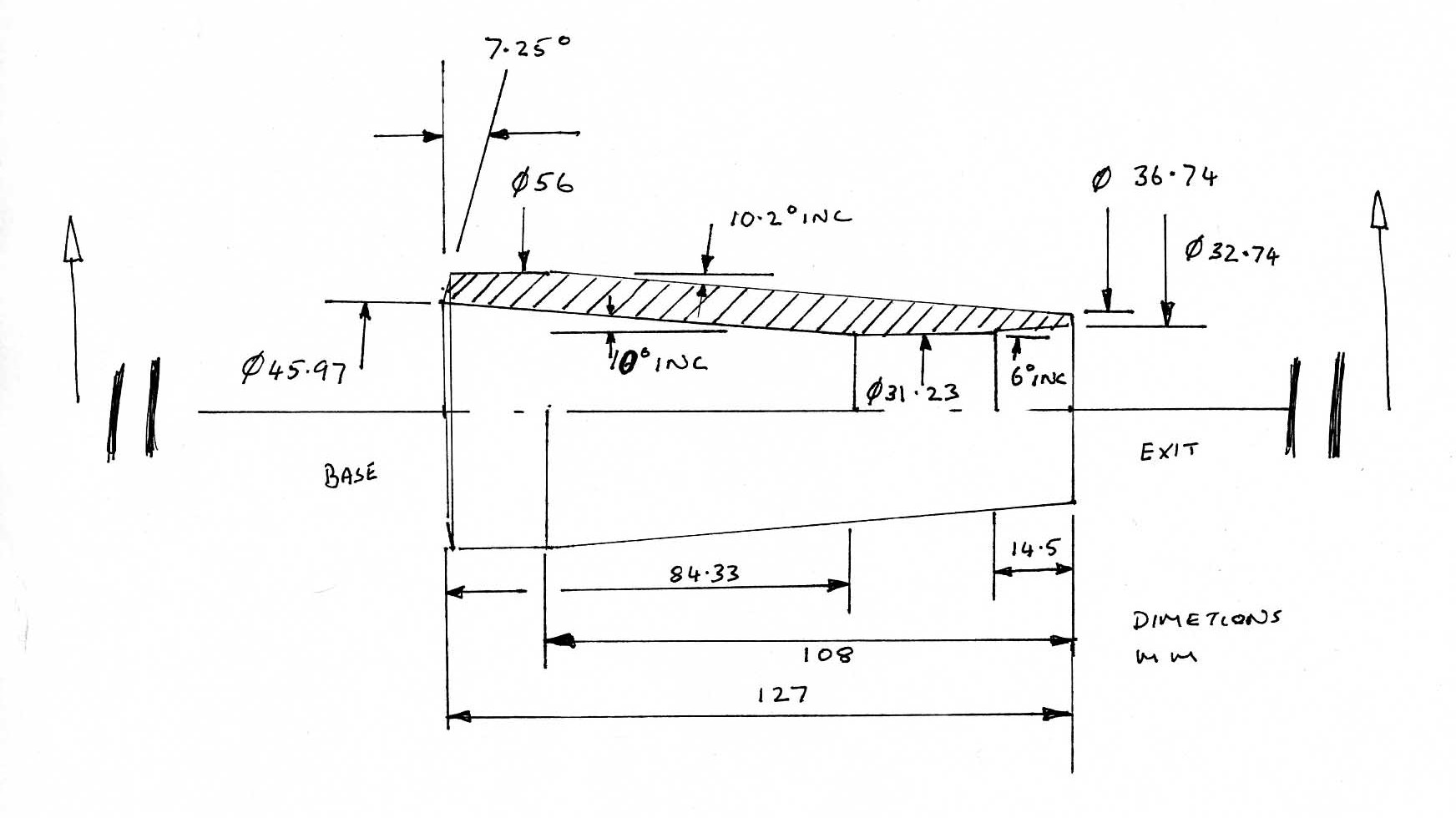

Nigel I am having your diagrams drawn up by my smart son in a cad program. I think all he has to do now is to dimension them, I hope he will do it tomorrow.
He said he will draw me component drawings so that I can get bits made.
Then I will put them on the forum for your comment.

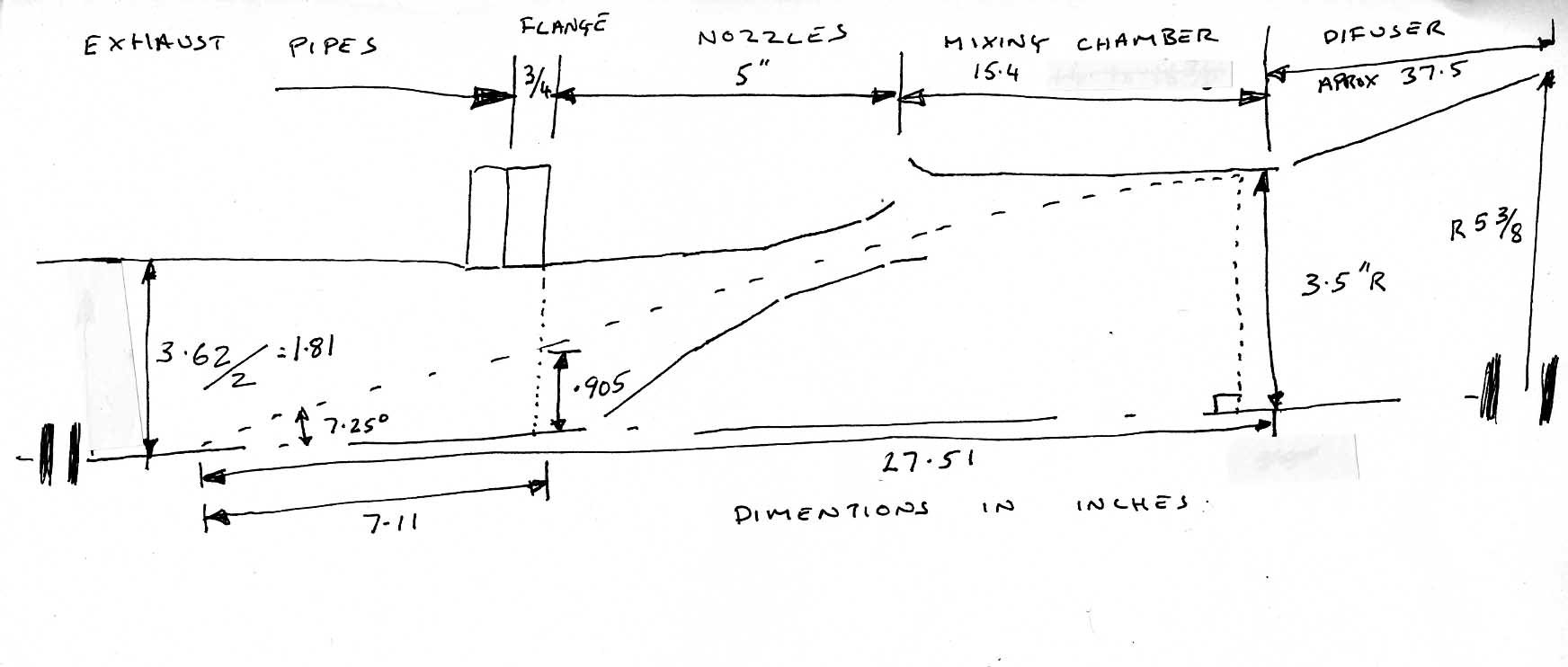

Right, The two diagrams above are firstly the layout of the nozzles relative to the exhaust pipes.
If ? I have done my sums right you can reuse the existing stand pipe. Having now seen the photos I realise why you wanted to put some sort of divider in the bottom. Its a good idea and I would think something like an aditional flange with the splitter fix from and below it.?
The stand pipe if reusable and has a suitable flange at the top should then have a suitable flange made to match. This flange needs to be thick and have a bore of 3.6 inches like the pipe. The top side of the flange where the nozzles will fit make a raised lip of 5 mm thick and heigh. If there are any small lips or sholder between the flange and pipe them then smooth them out. Like the main pipes smooth the bore of the stand pipe out. If all else fails then fabricate a new stand pipe but you dont need me to tell you how to do that. Drill a suitable hole say 1/4 BSP for the back pressure gauge.
The nozzles you have now seen in the second diagram have the De lavel form as we started the beginning of the thread. They have a very low co-eficent compared with a traditional nozzle which means that once reaching a terminal pressure they will produce more velocity and so the draught created does not falls off at high pressures. Such changes to nozzle size and shape can reduce the back presure which then allows a bigger presure drop across the piston and cylinder. A 1 pound drop in back presure can be the equivelent of an increse of 5 pound of main steam inlet presure. There are ideal sizes for nozzles but either the size of the loco or the avalable height never matches up. On the other hand once you go small then wire drawring in super small nozzles becomes a porblem and it why for these then 3 nozzles have to be done.
The angle and position of the nozzles is most important and why the mixing type of designs are more eficent. The 7.25 is constant for all types and the point of aim. This is the technical bit and I have no intention of going into complex science, just a comparative model explanation.
Imagine a welding torch to do gas welding. You have to hold the flame and its plume at a critical angle to gain the most heat transfer. What we are doing is the same with pressure.
The next model involves a hill side covered in mud. as the thickness of the mud builds up and up it exserts more pressure on the lower layers. In these layers the viscosity of the mud decresses with the increse in pressure. At the critical point where the vicosity is less than the friction holding the mud to the hill side the whole mud slide disapers down the mountain which is very much like a roller bearing.
The above discribs the braking down boundry layers and mixing action in the 'Mixing chamber' somthing which is still an ongoing study project.
The bottom edge of the mixig chamber needs to be roughly level with the top of the nozzles. and a smooth rounded of tapered entrance. There are many ways of making that.
The difuser above the mixing chamber is most important in many ways but at times I have had to sacrifice the eficentcy of the difuser to fit inside traditional chimneys. Its not the ideal and somthing I prefer to avoid if posible. Futher more the exit area of the difuser should be 4 times the area of the mixing chamber. It is very rare to get the full height of a defuser in a loco, and this is why double and multiple chimeys are fitted. In some resent requests I found that if a single chimney has been insisted upon then I would want another 100 to 150 inches of height. And some locos would have required more than 4 flues. So not a practical project within the specified limitations.
Just making a double rather than single flue will give you an extra 15% of natrual draught.
The nozzle drawring is not the full maching prosses and will be further explained for the milling and fabrication stages. Material for nozzles should be somthing like EN3B but not free cutting. I will draw a flange if you realy need but that's somthing you should be able to figure out. The overal and actual difuser size can be ajusted to suit. Also I want to add some pictures of how to mount the flue (more posts to write)
