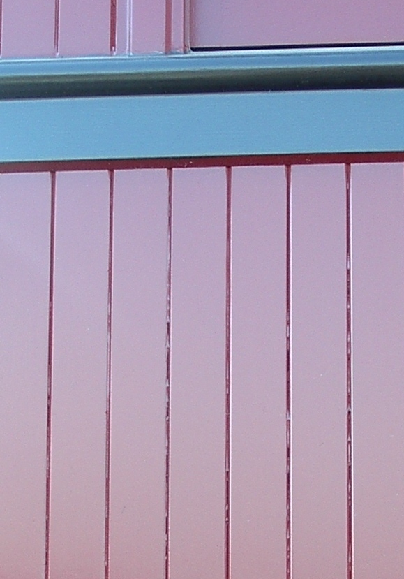

Mr. Hees, here's a shot of SRC 70 to address your requirements. The siding is milled T&G boards from Certainteed 4' x 8' sheets of their PVC siding. The sill above and window sash are mahogany. Window trim is also milled PVC.
I think it's important for everyone to remember that some of us are asking more from this equipment than the original purchasers. Our day coaches were built with some degree of planned obsolescence. We are asking the car bodies to roll and work through four extreme, humid seasons for decades under 21st century maintenance requirements. So far, the PVC is answering, though it must be kept to small dimensions in order to manage the expansion and the contraction.
We don't like the PVC any more than anyone else, but it is that or shrink the fleet.
